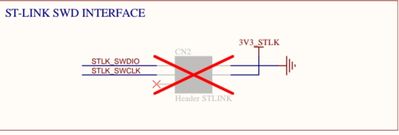

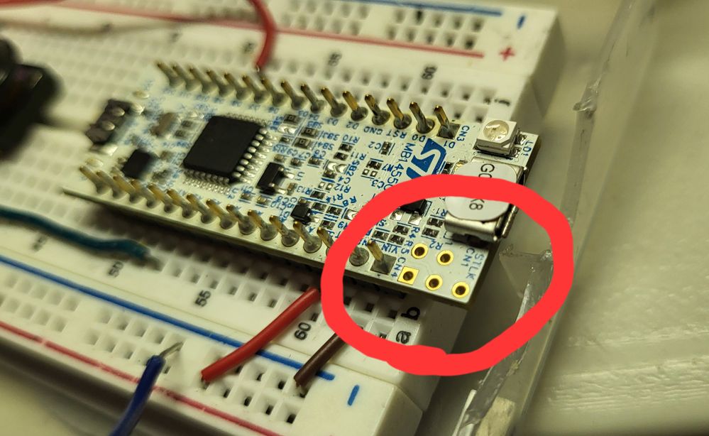

Does anyone know the exact pin-out of these five pins? I cant find anything in the documentation. Hoping it will allow me to use an external programmer.

According to the schematic MB1455 this is a 5 pads for ST-LINK SWD interface and it is Not fitted.

It is the SWD access to the interface STM32F103, Find it as CN2 in the Nucleo32 schematics.
Bcarpneter5
Thanks Everyone This Helped allot so the pin out is as following
GND , 3.3v
SWDIO , SWCLK , pin for holding the connector in place
