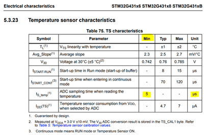

47.5 cycles at 36 MHz is not enough time to read the temperature sensor per the datasheet. Increase sampling time to max, or at least a value that satisfies the > 5us requirement.
I've changed the sampling time to 640.5 cycles for the themperature sensor... Clock prescaler is still set to "Synchronous clock mode divided by 4".
The ADC value is 909.
Regards,
Heinrich
Your board runs off of 3.3V (per the user manual), while the calibration values were taken at 3.0V (per the datasheet).
You can adjust for this by scaling your ADC value by 3.3/3, so use 1000 instead of 909.

Okay, with scaling by 3.3/3 I get the temperatures around 17-18°C. Room temperature is 24°C.
The calibration values are:
  • TEMPSENSOR_CAL1_TEMP = 30
  • TEMPSENSOR_CAL2_TEMP = 130
  • *TEMPSENSOR_CAL1_ADDR = 1040
  • *TEMPSENSOR_CAL2_ADDR = 1381
Regards,
Heinrich
waclawek.jan
While TDK already said probably all relevant things (did you calibrate ADC before use as he told above?), here is a generic checklist .There was a 'G4-specific documentation issue, too, so maybe check that one too.
Calibration was the essential hint... !
After a simple
HAL_ADCEx_Calibration_Start(&hadc1, ADC_SINGLE_ENDED);
it looks much better, now I get the mcu temperatures around 37°C and the other voltages aber more accurate (I'm reading two more voltages from potis).
