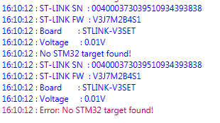

I am not able to connect my new custom board based on STM32H743BI with STM32CubeProgrammer using STLINK-V3SET. and get the "Error: No STM32 target found" when i try to connect.

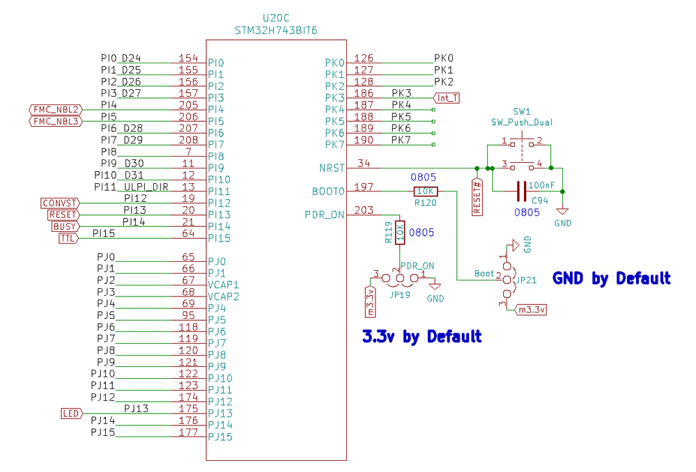

  • Reset is pulled high
  • Boot0 is pulled low

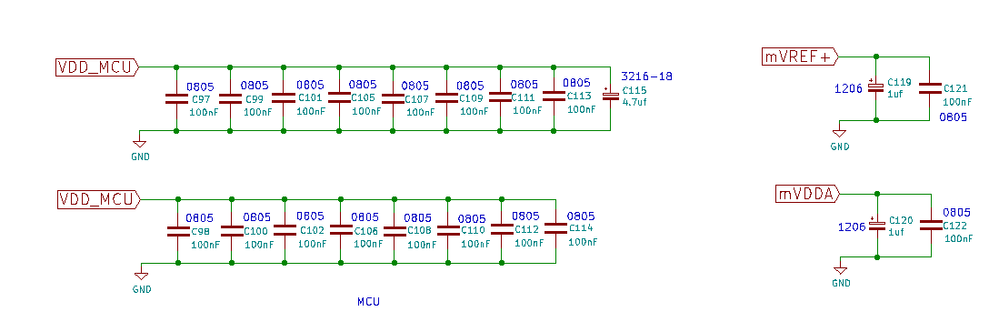

  • VDD is stable at 3..28V at all desired pins of the board
  • VCAP 1&2 connected to 2.2uF capacitors showing voltage of 1.01V.
  • VDDA is 3.28V, VSSA is Grounded,

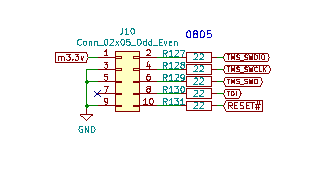

I am using a 10 pin SWD connector.
The Circuit diagram is shown below

J10 seems inverted to most other SWJ 10 pin layouts.
Thank You so much.....
You made my day.
it was the problem of connector footprint. it was supposed to be mirrored vertically. Now i am able to connect and programmed the MCU.
