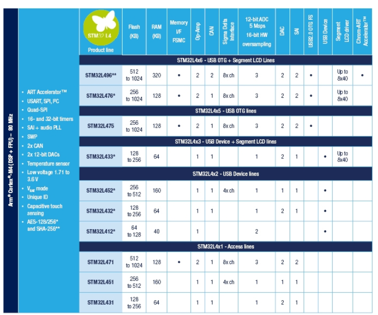

Need Evaluation Kit for this controller STM32L452RCT6 . Is there any alternate Eval Board available?

Actually In our Company the Controller is using STM32L452RCT6 Before Getting A sample Design Board. I need to test with any Eval Board of STM32L4 Series. I Need Evaluation Kit for this controller STM32L4RCT6 Is there any alternate Eval Board available. Hope I am looking forward for your reply.

There are several STM32L4R (L4+) boards in EVAL, DISCO and NUCLEO formats. These would likely suffice as proxies, lacking any specific stated requirements.​

Thank you for your response. As per our requirements the above 3 boards won't suitable , it doesn't have USB device support. The above reference Board support only USB OTG 2.0 FS. I need the Board with USB Device Support. Is it Board Available in Market with USB Device support. Hope I am looking forward for your reply.

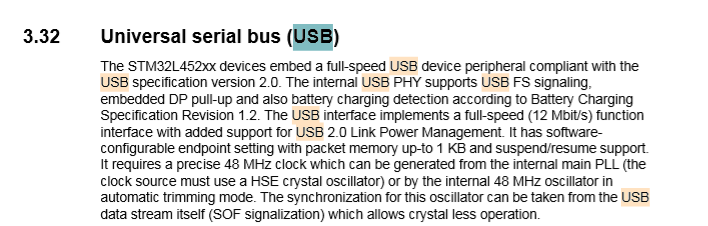

First, there is no such a STM32L4RCT6 MCU. Second, how about reading at least first lines in a data sheet?
The devices embed an USB OTG full-speed device/host/OTG peripheral with integrated transceivers. The USB OTG FS peripheral is compliant with the USB 2.0 specification and with the OTG 2.0 specification.

Actually, I am asking instead of a USB OTG full speed ,is it directly USB FS Device mounted on PCB Eval Board available or not.
Pretty sure these can be HOST or DEVICE, if that's what the question is. Look at board code examples in CubeL4.
Edit suggests a non L4+ device.​
0690X0000098MYmQAM.png0690X0000098MZ6QAM.pngHi Clive,
Thank for your response. Please find the snapshots for your reference. As per your suggestion I will go through Examples codes.
The predominant use case is as a USB DEVICE​
Yes, it is a vital Role.
