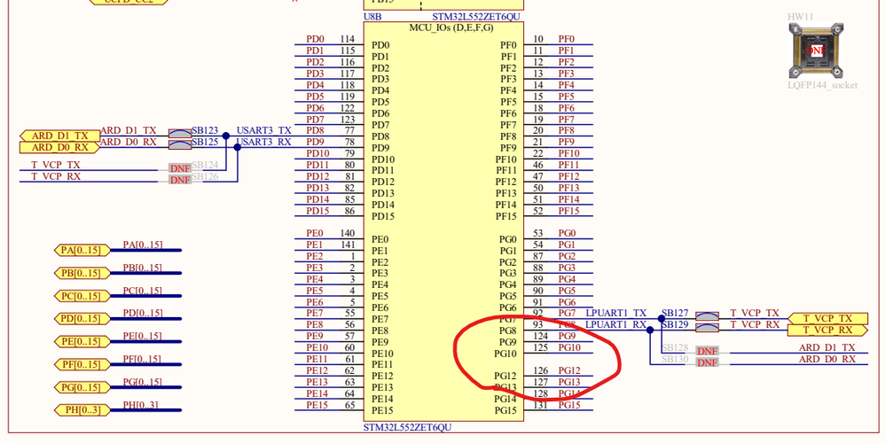

Is there an errata for the STM32L5 Nucleo board?
I need to use the SPI on port G which requires PG11 for SPI MOSI.
However in the schematic for the board, PG11 is missing from the schematic symbol (see page 3) and there is a gap.  The pin numbers in the symbol keep incrementing though.
https://www.st.com/content/ccc/resource/technical/layouts_and_diagrams/schematic_pack/group1/0f/01/93/eb/32/a6/42/56/MB1361-L552ZEQ-C02_Schematic/files/MB1361-L552ZEQ-C02_Schematic.pdf/jcr:content/translations/en.MB1361-L552ZEQ-C02_Schematic.pdf

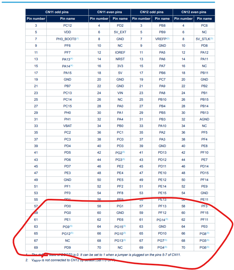

PG11 is also missing from the Nucleo Pinout table (page 39).
https://www.st.com/content/ccc/resource/technical/document/user_manual/group1/ad/a4/bd/5e/14/15/4e/e8/DM00615305/files/DM00615305.pdf/jcr:content/translations/en.DM00615305.pdf

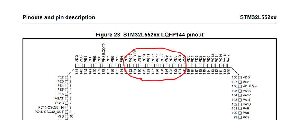

In the STM32L552xx datasheet (page 86), PG11 is assigned 126.

Same Data Sheet, different page

You need to look at the -Q (SMPS) device, it's apt to have moved the pins around.
You're looking / comparing the Wrong part. The Q parts cause all manner of pin compatibility headaches

I see your point about the Q part and that I was looking at the wrong datasheet.  Many Thanks.
Does this mean that the PG11 pin isn't accessible in the Q package?  Or is there another way to access the SPI MOSI on Port G?
The motivation for wanting to use the Port G SPI is to have SPI at a different voltage with VDDIO2.
Thank you.
