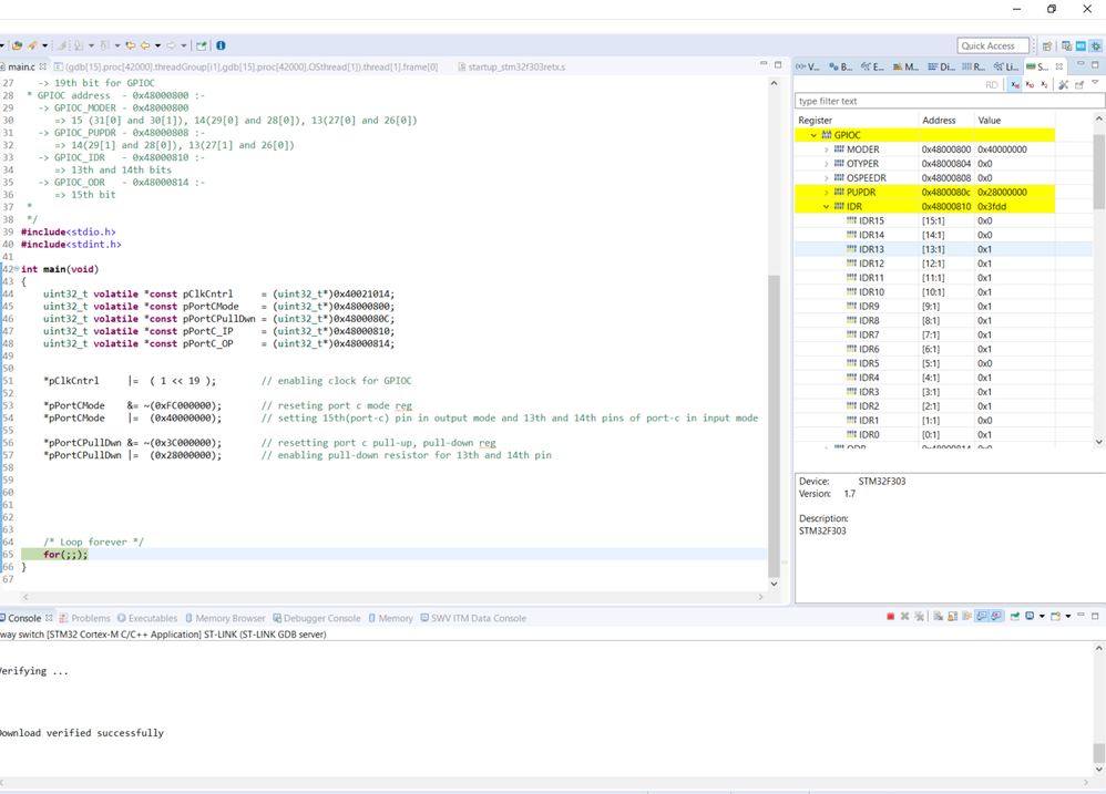

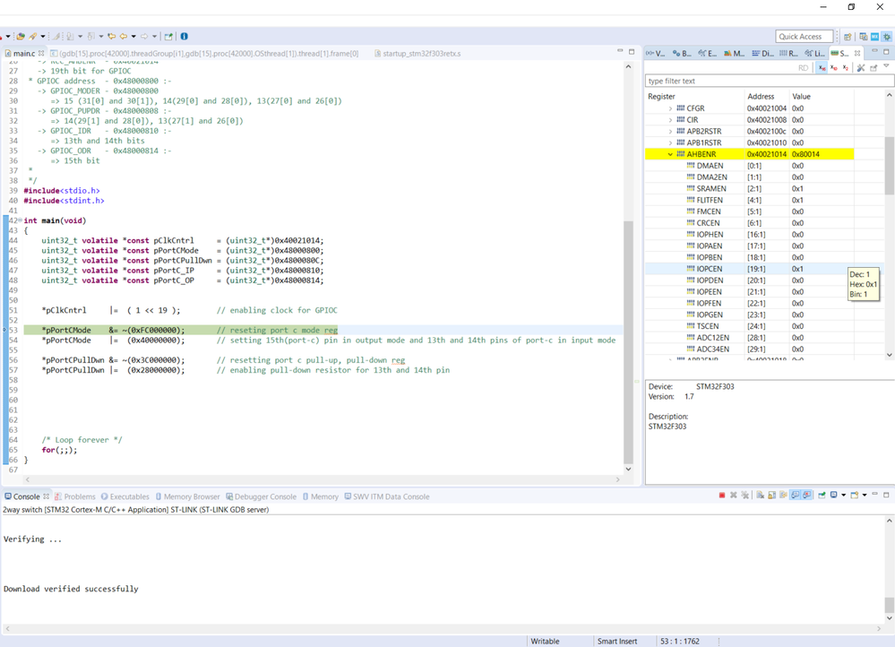

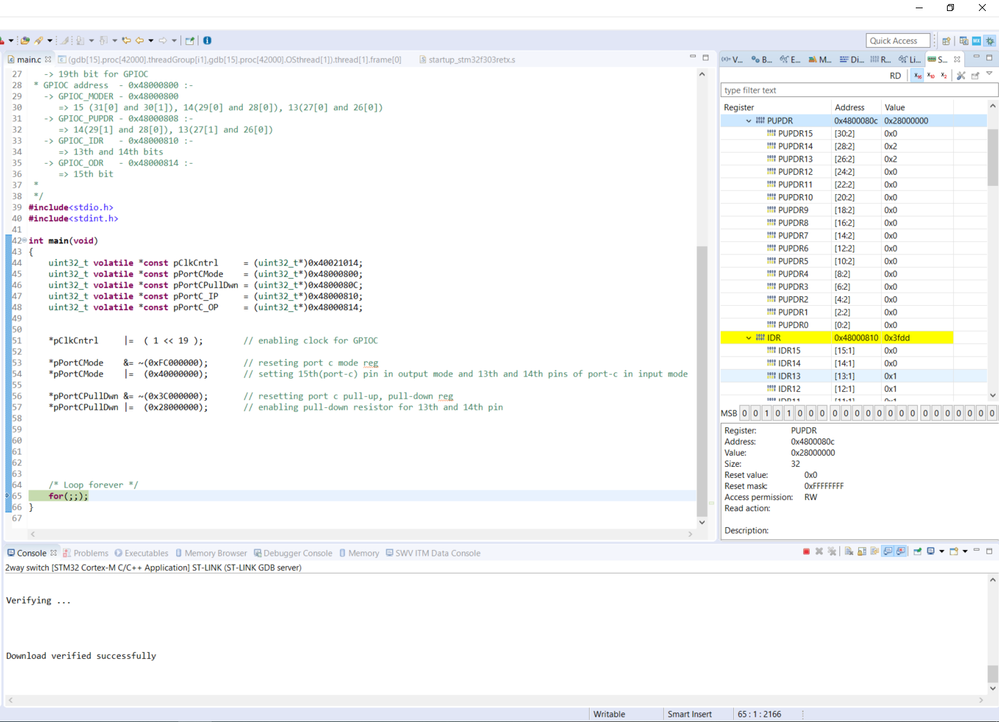

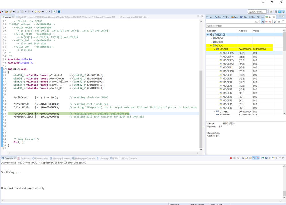

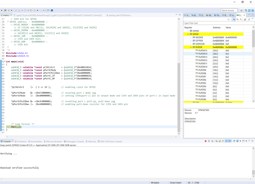

 I was implementing 2-way switch project on my Nucleo-F303RE. For that, I put the 13th and 14th pins of port-c as input and the 15th pin of the same port as output. I am using pull-down resistor for 13th and 14th pin but even after enabling pull-down resistor of these pins. SFR window in debug mode shows 13th bit of IDR still high.
 I have made sure that no pin should be connected to any external source
Here is my code and screenshots:

#include<stdio.h>
#include<stdint.h>
int main(void)
uint32_t volatile *const pClkCntrl      = (uint32_t*)0x40021014;
uint32_t volatile *const pPortCMode   = (uint32_t*)0x48000800;
uint32_t volatile *const pPortCPullDwn = (uint32_t*)0x4800080C;
uint32_t volatile *const pPortC_IP     = (uint32_t*)0x48000810;
uint32_t volatile *const pPortC_OP    = (uint32_t*)0x48000814;
*pClkCntrl   |= ( 1 << 19 );    // enabling clock for GPIOC
*pPortCMode  &= ~(0xFC000000);    // reseting port c mode reg
*pPortCMode  |= (0x40000000);    // setting 15th(port-c) pin in output mode and 13th and 14th pins of port-c in input mode
*pPortCPullDwn &= ~(0x3C000000);    // resetting port c pull-up, pull-down reg
*pPortCPullDwn |= (0x28000000);    // enabling pull-down resistor for 13th and 14th pin
    /* Loop forever */
for(;;);

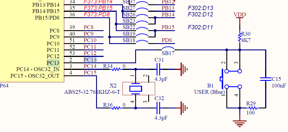

PC13-15 are not good choices since they're connected to things on the board.
Schematic is available on the resources page:
https://www.st.com/en/evaluation-tools/nucleo-f303re.html#documentation
You can remove these components but you'll also need to make sure PC13MODE, PC14MODE and PC15MODE are configured to allow these to work as standard GPIO pins.

thanks, by choosing different pins it worked
