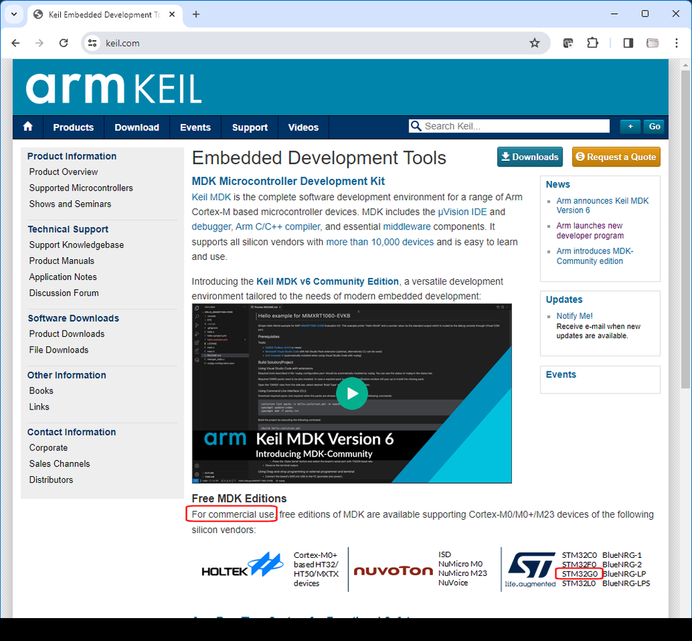

As far as I can read from the arm KEIL home page, MDKARM can also be used free of charge for commercial applications for users of Cortex-M0/M0+ derivatives of STM32, but limited to a code size of 256 KB. You'll also find the current Product Serial Number (PSN) at the URL you mentioned before. A similar topic regarding the Product Serial Number / License Key was discussed here.
If in doubt, it is best to ask Keil for final confirmation of this, which you are welcome to report back here.

@MaxC wrote:
Does this "free" license cover also commercial product development based on Cortex-M0/M0+ (like STM32G0) ?
You really need to ask Keil (ie, ARM) that - it's their product, and their licence terms.
https://www.arm.com/company/contact-us
But the Keil Home page does say:
You might also want to use the feedback options on that page:
