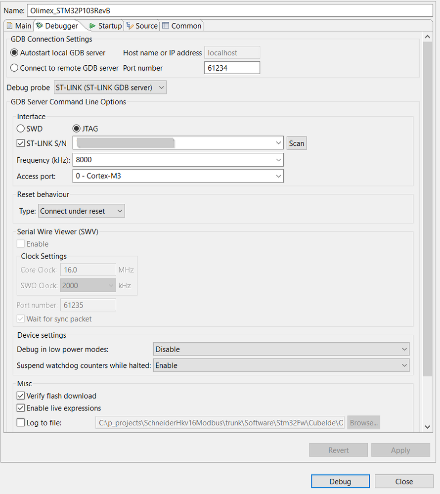

In the Meantime I tried my older STM32F103 Board with a ST-Link-V2, the ST-LINK GDB server works in 5-Pin-JTAG Mode, that works fine.
Does anyone use the JTAG on a Nucleo with 5-Pin JTAG?
Thanks a lot.
Best Regards, Seppel
Console, all good:

Waiting for debugger connection...
Debugger connected
            STM32CubeProgrammer v2.7.0-RC1
ST-LINK SN : (confidential)
ST-LINK FW : V2J37S7
Board    : --
Voltage   : 3.28V
JTAG freq  : 1125 KHz
Connect mode: Under Reset
Reset mode : Hardware reset
Device ID  : 0x410
Revision ID : Rev X
Device name : STM32F101/F102/F103 Medium-density
Flash size : 128 KBytes
Device type : MCU
Device CPU : Cortex-M3
Memory Programming ...
Opening and parsing file: ST-LINK_GDB_server_a21596.srec
 File     : ST-LINK_GDB_server_a21596.srec
 Address    : 0x08000000
Erasing internal memory sectors [0 24]
Download in Progress:
File download complete
Time elapsed during download operation: 00:00:01.855
Verifying ...
Download verified successfully

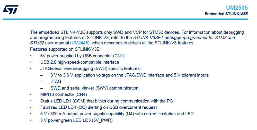

Hello Jan,
it's trivial, only SWD is supported, UM2505 User manual - Rev 4 - February 2021; STM32G4 Nucleo-64 boards (MB1367); Chapter "6.3 Embedded STLINK-V3E"; Page 11/44:
