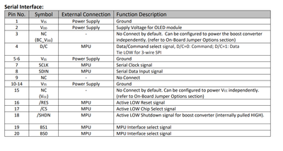

I want to interface  NHD-2.7-12864WDW3 OLED display having SSD1322 controller with STM32F407G-DISC1.

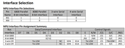

I am doing 3 wire SPI Communication, So i have connected all 20 PINS as follows:
Pin1 ---> GND
Pin2 ---> 3V
Pin3 ---> NC (No connection)
Pin4 ---> PD9 (DC; GPIO_Output, assigned by cubeide)
Pin5 ---> GND
Pin6 ---> GND
Pin7 ---> PA5 (SCLK; SPI1_SCK, assigned by coubide)
Pin8 ---> PA7 (SDIN; SPI1_MOSI, assigned by coubide)
Pin9 ---> NC (No connection)
Pin10 ---> GND
Pin11 ---> GND
Pin12 ---> GND
Pin13 ---> GND
Pin14 ---> GND
Pin15 ---> NC (No connection)
Pin16 ---> PB12 (RES; GPIO_Output, assigned by cubeide)
Pin17 ---> PB13 (CS; GPIO_Output, assigned by cubeide)
Pin18 ---> PB14 (SHDN; GPIO_Output, assigned by cubeide)
Pin19 ---> PB15 (BS1; GPIO_Output, assigned by cubeide)
Pin20 ---> PD8 (BS0; GPIO_Output, assigned by cubeide)
After flashing the code into the STM32F407G-DISC1 board, OLED display is still not glowing.
What is the error in this code that  i can't short out ,Because in this IED software also (0 Error and 0 Warning). So, i check the OLED display with necessary power check it was getting the Input power supply after that also i could not found the proper solution for that . If any one working on this microcontroller board pls help me with related documents.

I got the solution, There was a problem in Clock Configuration, I set the perscaler to 8 an my final Baud Rate was 2.625.
and its perfectly working

With quick review, looks that you have comment out spi transmission from ssd1322_hw_spi_send_byte- function ?
I would probably first double check signals and levels on the display connector with oscilloscope to make sure spi signals are working and also other display pin are in correct states.
