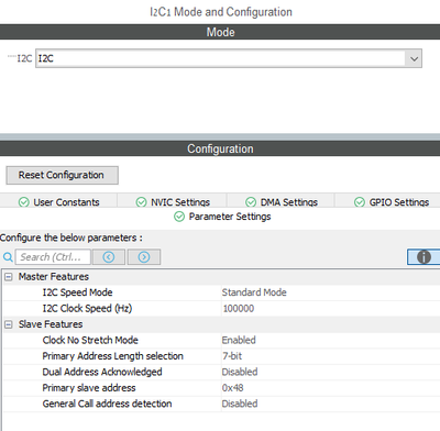

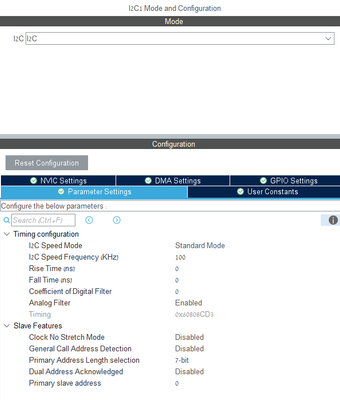

I am using NUCLEO-H563ZI as master I2C, and STM32F412G-DISCO board as slave I2C, which should mimic temperature sensor TMP117.
I am trying to send from master to slave a register number to read from, but the rx callback in the slave doesn't called.
Master configuration:
Master code:

Slave configuration:
Slave code:

At HAL_I2C_AddrCallback, err==HAL_BUSY, and HAL_I2C_SlaveRxCpltCallback isn't called, so register number doesn't received.
Do anyone have an idea what is wrong?

Yes, the NVIC is enabled.
Another information after further debugging: the master indicates that the communication is HAL_OK, but the slave indicates after the first received byte HAL_BUSY.
When than the master asks to receive 2 bytes, it gets twice the slave address with the Read/Write byte high
