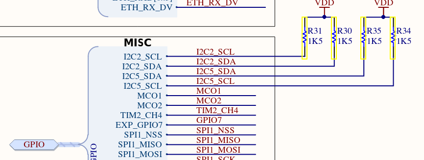

I2C PULL UP RESISTORS
Gencay
In disco boards and evaluation boards there are 1.5k Ohm resistors, would it be a problem if I use 2k Ohms? 0693W00000SuaSeQAJ.png
Javier1
Principal
unless youre using an inusually large i2c bus or an inusually large i2c freq, i would say no problem.
