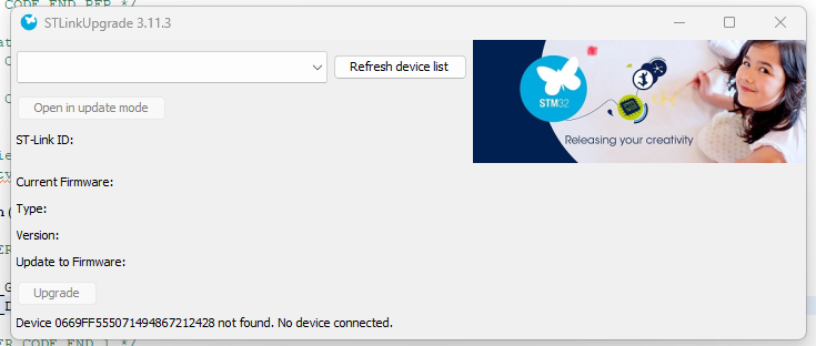

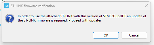

when ı try first time said this:0693W00000aJEpyQAG.pngwhen ı said ok and update said this:0693W00000aJEqDQAW.png
Depending on the operating system it can take a while to load the drivers for the ST-LINK once it switches to update mode.
Do you see it in DEVICE MANAGER?
Did you get a pop-up indicating it was searching for a driver? Or does Device Manager indicate it hasn't found/associated a driver with the ST-LINK ?
Once it has a driver, click Refresh and see if it shows up in the update application.

I tried for stm32f072 and app found board. After that updated board. But stm32f334 isn't updating ı dont know why board isnT detected.
