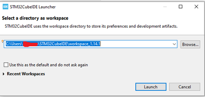

This window will be shown, click "Launch" button:

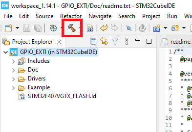

and wait until the project workspace is loaded. You have to get this view:
SofLit_1-1710425221784.pngHope
Then click on the "Hummer" button to build the project. When it was completed,

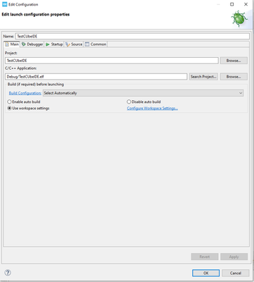

Click on the arrow button shown in red and go to the menu shown below:
If this window is shown, click OK button to load the program to your MCU target and launch the debug session:
To run the program click on this button:
To stop the debug session click on this button:
