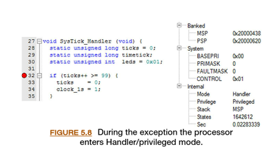

I thought it would be an easier task, just adapting the HAL calls, and kernel (C and ASM) routines would keep the same. But I am having an strange behavior: when SysTick handler is called (and it is the one who triggers PendSV) my CONTROL == 0x01, which means I am not on priviliged mode. How could that be possible?

Was looking at a book, see when on SysTick Handler, the nPRIV bit of Control is 1, even though the system is said to be in privileged mode. (
Martin, Trevor. The Designer's Guide to the Cortex-M Processor Family
Bob S
November 7, 2023
nPRIV indicates the privilege level or THREAD mode.  Handler mode (interrupts/exceptions) ALWAYS runs in privileged mode.  See ST's PM0253 (STM32F7/H7 Programming manual) section 2.1.1.
