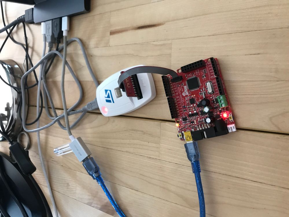

JWojt.1
Hi Ons,
I don't know if desribing it would do any good so here is a picture showing my cable connection:0693W000000VK2xQAG.jpg
As you can see I am using one cable to connect the board to the PC with the micro USB port and one cable to use the StLinkv2 with the JTAG cable.
I was hoping that after loading the code on the board I would be able to loose the StLinkv2 and communicate via RealTerm with only cable remaining.
Again, thank you for your feedback.
Sincerly,
Jan
Ons KOOLI
Senior III
Hi JWojt.1,
It seems that your setup is good.
Please refer to CDC_Standalone projects in STM32Cube firmware.
  • "I was hoping that after loading the code on the board I would be able to loose the StLinkv2 and communicate via RealTerm with only cable remaining."
    • I think this is your problem. Can you explain more in details? It is not clear to me.
    • With this configuration you are presented in the picture, and after loading your CubeMX generated project into your board, is your device enumerated by Host ?
Best Regards,
Ons.
