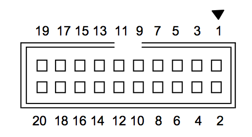

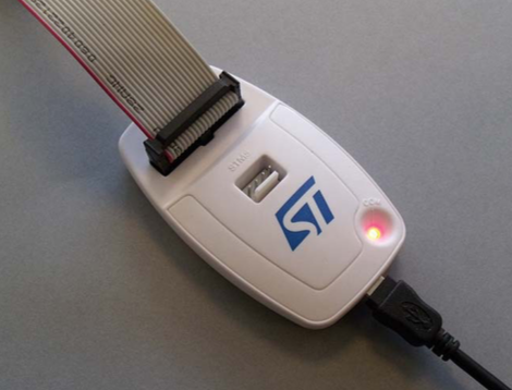

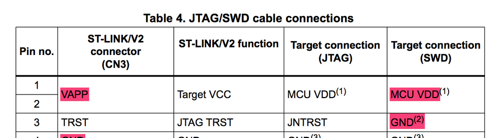

Ken Inoue
Posted on July 02, 2017 at 15:32
Thank you for your reply.
I'm sorry for my poor English.
I think
Original ST-LINK programmer have a power on the VAPP pin.
The photo above is Original ST-LINK programmer.
Here is part of Original ST-LINK programmer manual. According to this, there is a VAPP pin.
Posted on July 02, 2017 at 15:39
I believe that you have verified the voltage supplied to the target MCU.
S.Ma
Principal
Posted on July 02, 2017 at 16:04
To my understanding, the stlink monitors the application vdd, and refrain from being an applucation supply voltage.

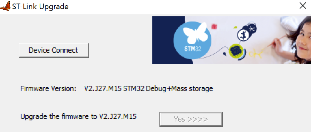

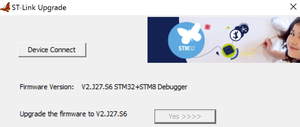

Posted on July 02, 2017 at 15:18
I'm very happy to reply because I am in great trouble.
1. Yes. T
he original build-in ST-LINK work fine.
3. I upgrade ST-Link.
But the same error appeared.
The photo above is Nucleo ST-Link version
The photo above is External ST-Link version.

Ken Inoue

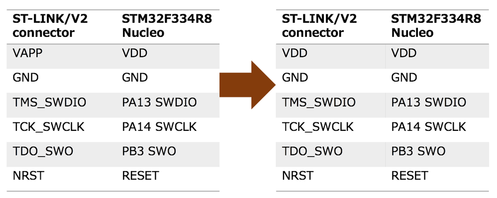

Posted on July 02, 2017 at 17:30
Thank you everybody.
I'm sorry. I noticed that VAPP voltage is 1.5V. My target MCU supplied voltage is 3.3V.
So I changed it as below.

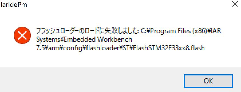

But an error in the figure below appears.
I translate this into English. ?
