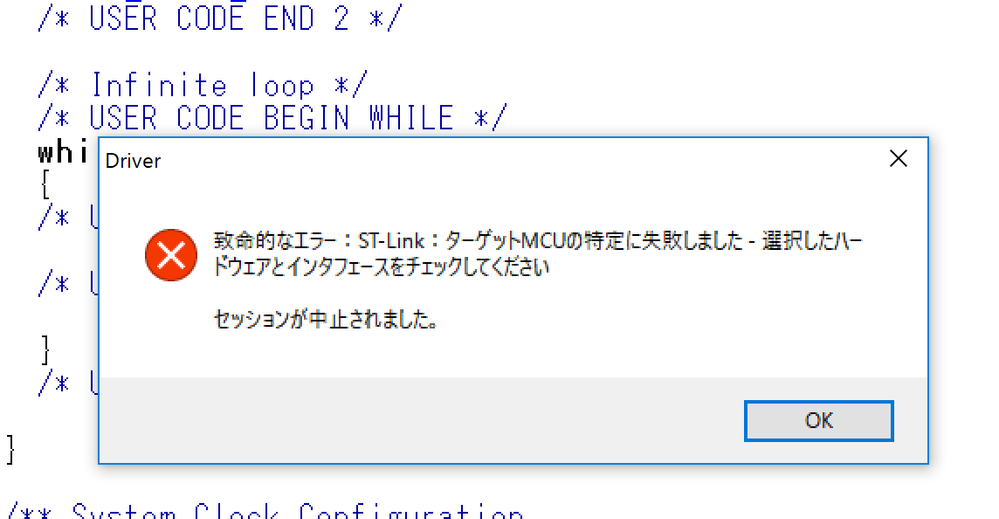

I connected ST-Link / V2 as shown below.
 However, an error was displayed as shown in the figure below. I translate this into English.
�Fatal error : ST-Link: Failed to identify the target MCU. Please check the selected hardware and interface. Session aborted.''

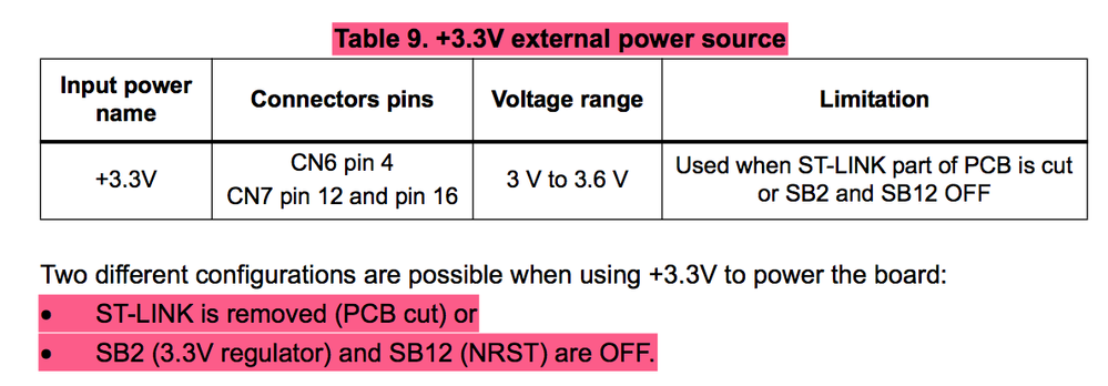

Posted on July 02, 2017 at 17:45
Read again user manual chapter #4 of UM1075
Table 4. Than under table you could see.
'1. The power supply from the application board is connected to the ST-LINK/V2 debugging and programming
board to ensure signal compatibility between both boards.' How do you think, what does it mean?

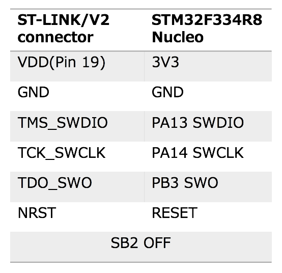

Posted on July 03, 2017 at 05:44
Hi Inoue-san,
Try this.
ST-LINK VDD (Pin 19) -> Nulcleo 3V3 (SB2 OFF) or JP6(IDD)-VDD side (See UM1724)
STK-LINK VAPP (Pin 1,2) -> same as above.
NOTE: ST-LINK VDD is provided via 10 ohm.
VDD provides 3.3V from the ST-LINK side.
VAPP is monitor the target VDD.

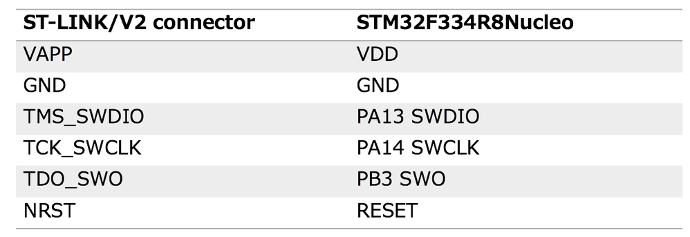

Posted on July 03, 2017 at 12:13
Thank you for your reply. Your reply was helpful. But the problem is not solved.
I followed your advice as shown in the figure below.
But the same error appeared.

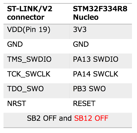

I found the following description in UM 1724.
So I changed the figure below.

Posted on July 03, 2017 at 14:11
Hi Inoue-san,
You should connect both VDD and VAPP to 3V3.
