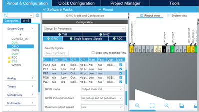

I connected the anode from a diode to the operating voltage and the cathode to a pinx. I need ground to make the diode glow.  How can this be implemented?

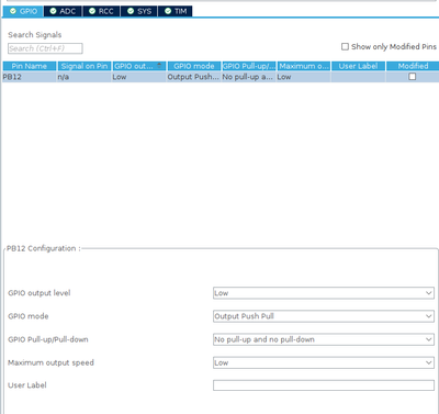

To drive the pin low, just define it as a output , then set this low.
( here pb12 , just to show )
HAL_GPIO_WritePin(GPIOF, GPIO_PIN_3, GPIO_PIN_RESET);	// LED ON

So try : set in cubeMX  (-> xx.ioc) GPIO pin as output and at low level.
-> generate code , -> compile , -> debug --- and led is on.  If not : your on the wrong pin (number or name).

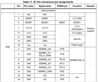

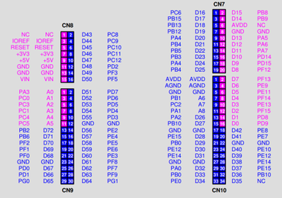

I did exactly the same. I'm using pin 14 and pin 16. On stm32 are the PF3 and PF5. I'm still measuring 1.9V voltage at the cathode.
But you wrote: HAL_GPIO_WritePin(GPIOF, GPIO_PIN_5,GPIO_PIN_SET);
this sets pin high.
Test:  write NO progam, nothing, let only Cube make the init.
Just generate code, compile, debug -> pins are low.
Can you debug ? Then check gpio setting in SFRs view.
