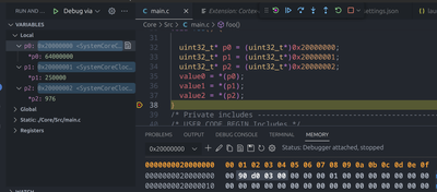

I am trying to understand the memory on my STM32F302R8
Looking in the manual I understood the SRAM to be at 0x2000 0000 - 0x2000 3FFF
This is the first time I have used VS Code for Cortex and understood that I would be able to view this using the Memory View pictured below
I might be doing this wrong but I did expect the view to match the watch.
Thanks all.
2 REPLIES 2
KnarfB
The windows do match. 64000000 decimal is 0x03D09000, shown in the memory view but it looks different because the MCU is in little-endian mode. And so on...
