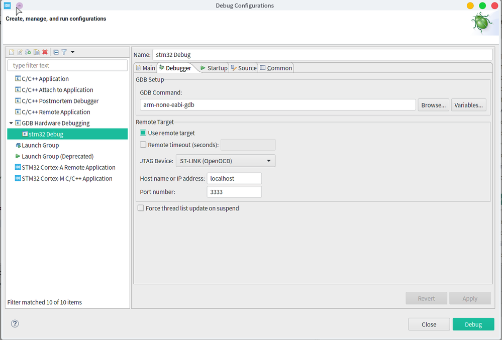

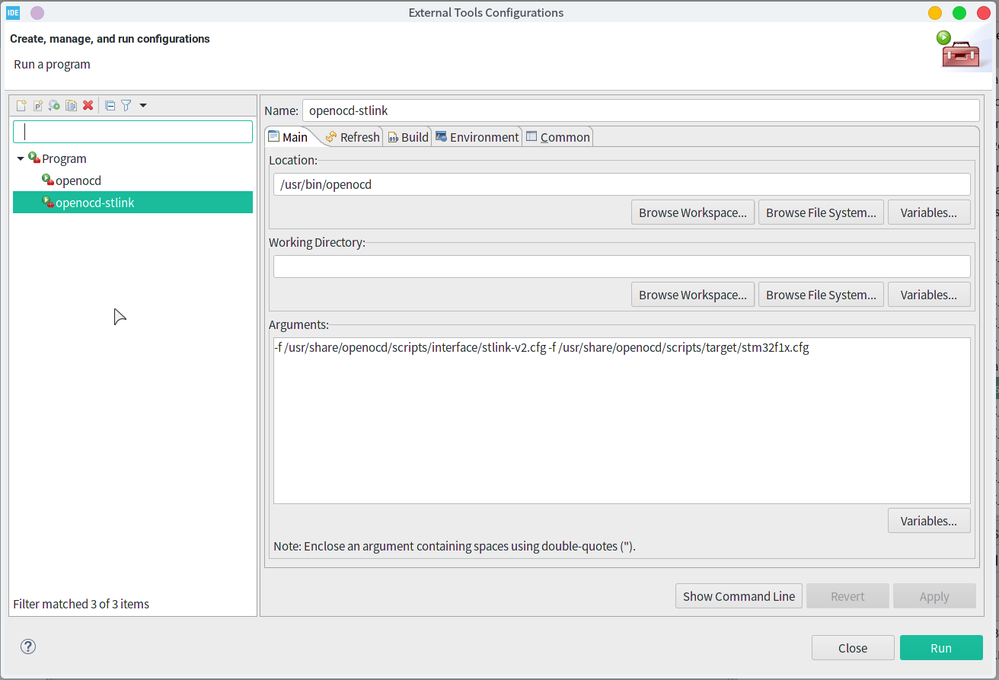

‎2021-03-04 09:39 AM
2 ways:
- download stlink-server file from ST.com, extract, get stlink-server.2.0.2-1 excutable file. move it to /usr/bin, and rename to stlink-server.
- use openOCD instead.
- ) install openOCD.
- )stm32cubeide--run--externaltools--externaltools configuration (or you can excute openocd in terminal:#openocd -f /usr/share/openocd/scripts/interface/stlink-v2.cfg -f /usr/share/openocd/scripts/target/stm32f1x.cfg)
- dubug configuration, use GDB Hardware Debugging, not STM32 Cortex-M C/C++ Application. GDB command=arm-none-eabi-gdb. JTAG device=ST-LINK(openOCD).
