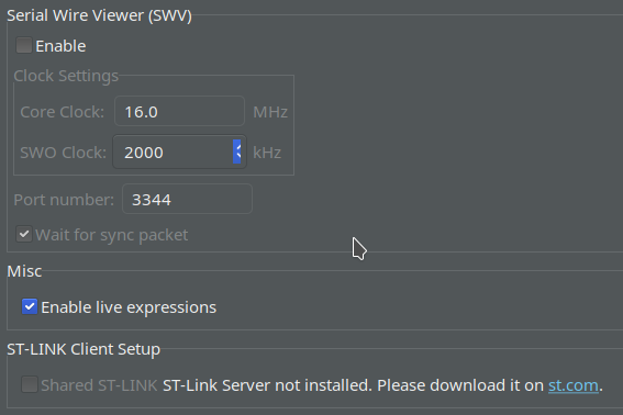

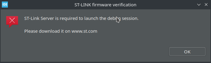

CubeIDE does not see ST-Link Server
Hello. I don't know exactly what the IDE needs, but it doesn't seem to see the St link server, but at the same time says that it is installed. When you press the Debug or Run button, a window appears with the inscription "ST-Link Server is required to launch the debug session. Please download in on www.st.com".0693W000006Ej45QAC.pngI tried versions 1.5, 1.4 and as far as I remember 1.1. I wanted to try other versions, but the download was constantly interrupted. Is it just me or everyone? It looks like the site needs mirrors.

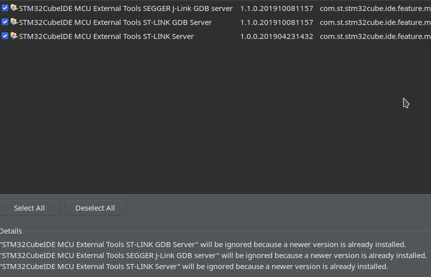

I also tried to install the server through Help> Install New Software ... Answer:
"Cannot complete the request. See the error log for details.
"STM32CubeIDE MCU External Tools ST-LINK GDB Server" will be ignored because a newer version is already installed.
"STM32CubeIDE MCU External Tools SEGGER J-Link GDB server" will be ignored because a newer version is already installed.
"STM32CubeIDE MCU External Tools ST-LINK Server" will be ignored because a newer version is already installed."0693W000006Ej4AQAS.pngMy main system is Manjaro Linux (system updated). Everything works well on Windows 10. I tried to program two boards and there were no problems.

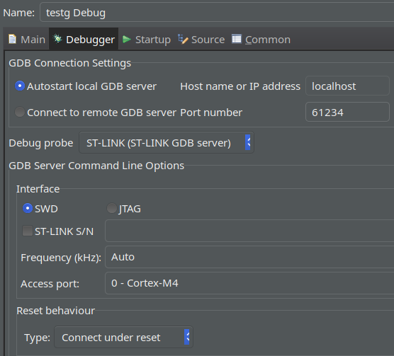

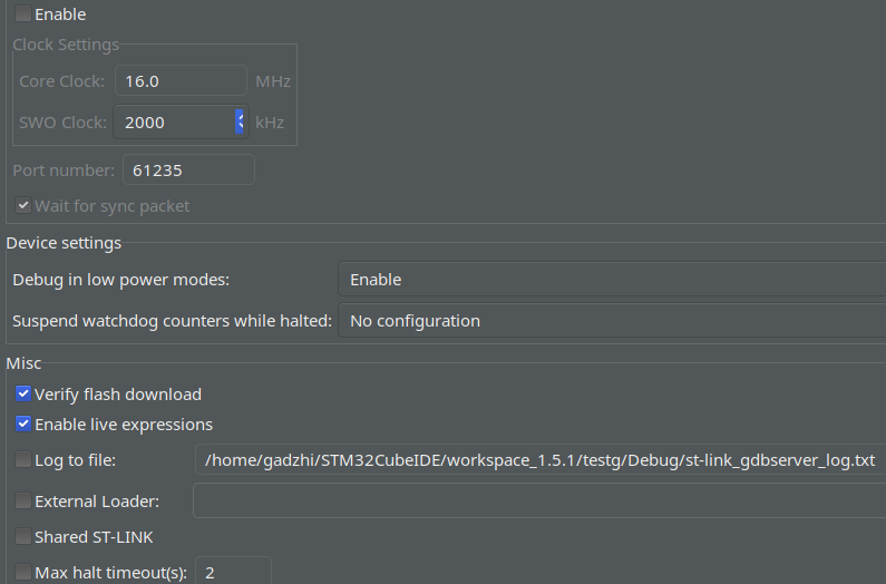

This is the default debugger configuration
0693W000007B9MVQA0.png0693W000007B9MLQA0.png0693W000007B9M1QAK.png0693W000007B9LwQAK.png

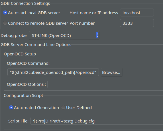

2 ways:
  1. download stlink-server file from ST.com, extract, get stlink-server.2.0.2-1 excutable file. move it to /usr/bin, and rename to stlink-server.
  2. use openOCD instead.
    1. ) install openOCD.
    2. )stm32cubeide--run--externaltools--externaltools configuration (or you can excute openocd in terminal:#openocd -f /usr/share/openocd/scripts/interface/stlink-v2.cfg -f /usr/share/openocd/scripts/target/stm32f1x.cfg)0693W000008w4WYQAY.png
    3. dubug configuration, use GDB Hardware Debugging, not STM32 Cortex-M C/C++ Application. GDB command=arm-none-eabi-gdb. JTAG device=ST-LINK(openOCD).0693W000008w4XHQAY.png
