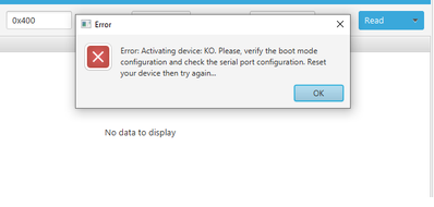

I'm encountering a problem transferring a bin file via UART on my Stm32f103c8t6. While UART3 functions correctly with a USB TTL converter, UART1 doesn't seem to establish a connection.
- I've verified the connections between the device's UART1 pins (TX and RX) and the USB TTL converter.
- I'm using the appropriate baud rate settings on both the device and the terminal software.
Solved! Go to Solution.

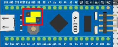

‎2024-06-12 5:51 AM
Hello @snehadakhare01 ,
Make sure that BOOT0 is High.
Check that you are properly connecting the pins supported by the bootloader, as described in AN2606 STM32 microcontroller system memory boot mode - Application note.

‎2024-06-12 10:22 PM
Hi @Imen.D
Bootloader status was set like this
When TTL Rx and TX are connect to PA9 and PA10 (UART3) it is working
But I want to connect TX and RX to PB6 and PB7(UART1) of Bluepill that time it is showing error
Connection
TTL | Bluepill |
TX | PB7(Rx) |
RX | PB6(Tx) |
VCC=3.3 | VCC=3.3 |
GND | GND |
