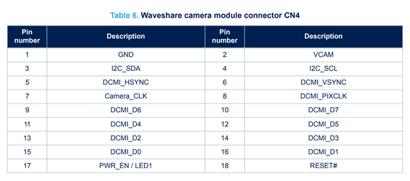

You can connect the Nucleo board to only the camera by using CN2 or you can connect it to the B-OMV-Cam by using CN4 as mentioned UM2779.

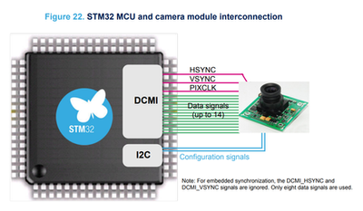

As shown in the below figure, the camera module is connected to the DCMI through the following signal types:
• DCMI clock and data signals
• I2C configuration signals
For that, it is necessary to refer to the Camera module and to the board Schematics and to MCU datasheet and check the required pins for this connection.

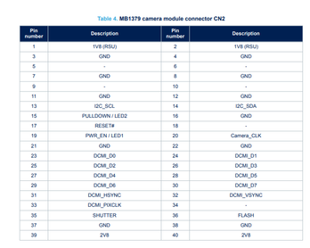

This connection made with CN2 connector as shown in the below table.

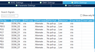

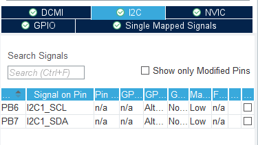

To find the required pins used to connect STM32H7A3 and board schematic with an camera module, I advise you to refer to the datasheet and search the pins of DCMI clock and data signals and I2C configuration signals.
Also you can find the pins connection of Nucleo-H7A3ZI-Q with an camera module by using STM32CubeMX, choose Nucleo-H7A3ZI-Q  then enable DCMI.

I wasn't able to figure out how to connect my components. I have the OMV cam bundle and the CN2 connector is already used by the camera. I tried to initiate an SPI connection but it did not go very well (mostly struggle with the MXide).
Maybe I could do with the camera only but I do not have the right wires to connect the board to the CN2 on the camera.
