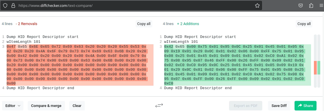

Dump HID Report Descriptor start
wItemLength 101
0x81 0x02 0xC0 0xA1 0x02 0x75 0x08 0x95 0x07 0x46 0xFF 0x00 0x26 0xFF 0x00 0x09 0x02 0x91 0x02 0xC0 0xC0 0xFF 0x75 0x01 0x09 0x31 0x09 0x32 0x09 0x32 0x09 0x35 0x81 0x02 0x75 0x04 0x95 0x01 0x25 0x07 0x95 0x08 0x25 0x01 0x45 0x01 0x09 0x01 0x81 0x02 0xC0 0xA1 0x02 0x75 0x08 0x95 0x07 0x46 0xFF 0x00 0x26 0xFF 0x00 0x09 0x02 0x91 0x02 0xC0 0xC0 0x00 0x00 0x00 0x00 0x00 0x00 0x00 0x00 0x00 0x00 0x00 0x00 0x00 0x00 0x00 0x00 0x00 0x00 0x00 0x00 0x00 0x00 0x00 0x00 0x00 0x00 0x00 0x00 0x00 0x00 0x00 0x00
Dump HID Report Descriptor end
Output data via STM32F407VGT6 UART (Attempt 2):
App start
MCU-ID 10076413
USB Device Connected
USB Device Reset Completed
VID: 0079h
PID: 0006h
Address (#1) assigned.
ERROR: Control error: Device not responding
ERROR: Control error: Get Device configuration descriptor request failed
VID: 0079h
PID: 0006h
Recovering USB module
VID: 0209h
PID: 0029h
VID: 0079h
PID: 0006h
VID: 0079h
PID: 0006h
Manufacturer : DragonRise Inc.
Product : Generic USB Joystick
Serial Number : N/A
Enumeration done.
This device has only 1 configuration.
Default configuration set.
USBH_HID_InterfaceInit
Interface 0, cannot find the HID_BOOT_CODE, skip
Interface 0, try to find the HID_CUSTOM_BOOT_CODE
Switching to Interface (#0)
Class : 3h
SubClass : 0h
Protocol : 0h
Custom device found!
max_ep: 2
Interface 0, endpoint #0: address 0x81, attributes 0x03
Interface 0, endpoint #1: address 0x01, attributes 0x03
HID class started.

As can be seen, the HID Report Descriptor data is not the same:
Is STM32 not checking packets for errors?
Improper USB Packet Data and Data Sequencing
USB packets contain error checking mechanisms, including a CRC bit to ensure data validity and a toggle bit in the PID packet to ensure correct data sequencing. Sometimes during USB data transmission, even these can become compromised if there an error in this mechanism, causing individual USB transactions to be dropped or causing reduced throughput.
For instance, if the data packet is corrupt and the CRC is invalid, the receiver will send a NAK bit to the transceiver, informing of an erroneous data packet. Transceivers will then resend the data multiple times, but this can in turn cause data packets to drop as the receiver may consider this to be duplicate data.
One example of an incorrect sequence includes incorrect data bit toggling. In a normal data transaction, the data PID will toggle between DATA0 and DATA1 consecutively, however, if there are issues with this, data retransmission can occur where the toggle bit does not update correctly, causing a repetition of the same toggle bit. In these cases, sequential DATA0s or Data1s are not passed to the application because the receiver will ignore packets that are repeating. This will cause data to not be passed to the application.
