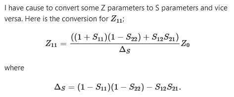

I also have trouble measuring the Q factor of an antenna with a MiniVNA Pro. In your last message, you provide 2 screenshots for which I would like some precisions :
  • The first one is, according to the display, S22. So when does the conversion to Z:Reflection mentioned in the AN4974 steps in ? I also assume that S22 is equivalent to S11 in your setup, is it true ?
  • The second one is the Return Loss which is related to the S11. You advise to convert it to Z-parameter, but to do so you need S21, S12 and S22 (see formula below).

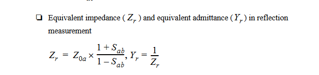

This last point on S21 is true for both. According to the Agilent E5061A/E5062A ENA Series RF Network Analyzers User’s Guide, Zreflection is a function of Sab (see image below), which is S21 to me.
0693W00000QM9npQAD.pngMy question is : did you perform a transmission measure ? How ?

Yes the conversion with the above formula is do able. Anyhow our VNA has a build in conversion function which does the job.
