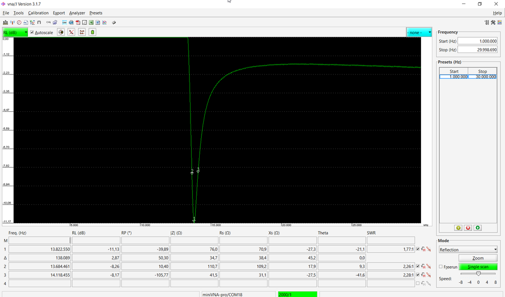

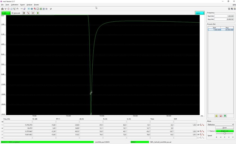

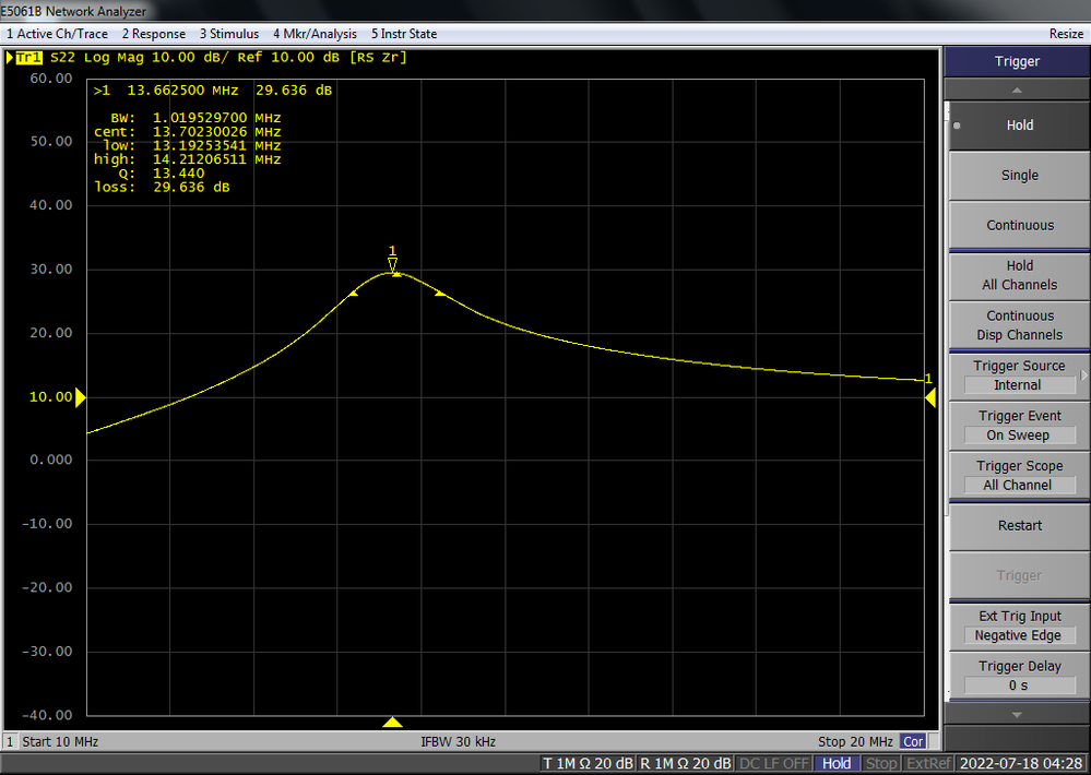

I have captured two traces: first one is taken with our Keysight VNA:
0693W00000QLRpWQAX.pngThe second one is captured with the miniVNA pro:
0693W00000QLRq5QAH.pngYou can use this pictures to compare the two results. Both use the same antenna and same tag on top.
The miniVNA is missing the Z-conversion. But i assume you can export the S-parameter and do the conversion externally.

Typically when using a VNA a OSL calibration is done (open-short-load). Some VNA also support additional calibration methods. Our E5061B VNA from Keysight also supports such "short" calibration - besides the OSL calibration. The idea is to calibrate away the characteristics of the pickup coil, and be able to only sense the characteristic of the reader or tag antenna - since the antenna is still connected during the "short" calibration.
A OSL calibration would only calibrate the VNA port + cable. The characteristic of the pick-up coil would overlap with the characteristic of the reader or tag antenna.

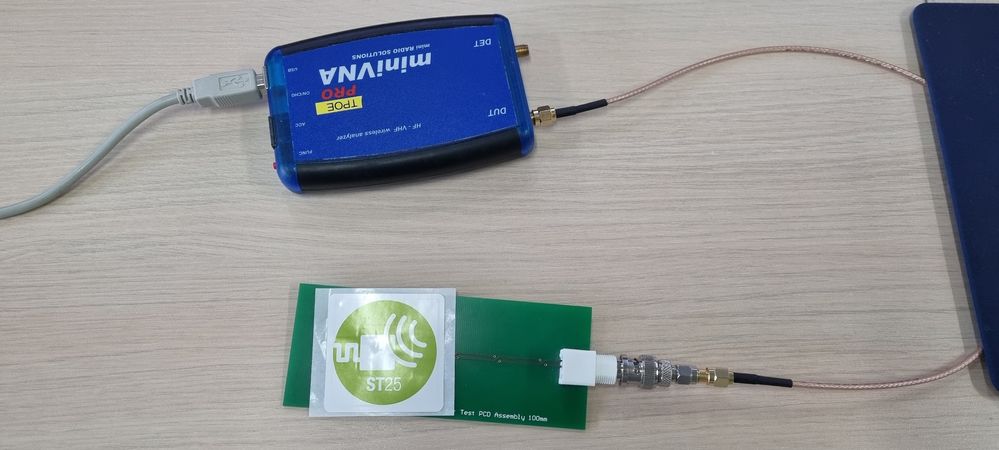

Travis Palmer
Hello Ted,
i had another look with my colleague.
If you replace the short during OSL calibration by the antenna, you can sense the resonance frequency of the tag.
I can crosscheck the results next week, once I have access to our VNA again.
Below a picture of my setup + measurement result.
br Travis
