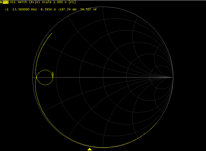

Travis Palmer
Hello Oliver,
I modified one of our ST25R3916-DISCO board to ~8.4Ohm which gives a driver current around 350mA.
The supply is done via USB (~4.8 to 5V).
0693W00000LwntjQAB.pngIf selecting an in-proper setting Reg: 2Ch = 0xf8 (too less drop) and then turning on the field, the Regulator display register is showing 0xf1 => i_lim bit is "1".
When selecting an proper setting (Reg: 2Ch = 0xd0 => 4.6V), then the i_lim bit is "0".
Values above trigger the i_lim bit to "1".
(Regulator display register is showing 0xa0).
The Procedure is always: Go to "ISO 14443A" tab, press configure and modify the registers via "Register map". Read back / update the register map via "Ctrl + R"
BR Travis

Travis Palmer
Hello Oliver,
can you prepare your setup to measure the supply current?
We cannot simply do a DC operating point calculation to estimate the current consumption.
The typical NFC application has a matching network attached to the RFO pins. This matching network transforms the inductive impedance to a real ohmic load. The EMI filter is the first part of this matching network.
The EMI filter is transforming the rectangular voltage, which is outputted by the driver into a sinus shaped voltage. As a result, also the current going through the regulator is approximately sinus shaped. This is because the drivers produce a square wave voltage, but the EMC filter only passes the first harmonic.
below an example of calculating the current and also the dissipated power:
Input parameters:
VDD = 5V
Mathing Impedance = 8.4Ohm
LDO drop = 0.3V
RDRV = 1.75Ohm
IAL = 0.021A
Calculation:
PAL = VDD * IAL = 5 * 0.021 = 0.105 W
PREG = (VDD – VDDDR)*(VDDdr*1.27*0.637)/(2*RDS_on + ZLoad) = (5-4.7)*(4.7*1.27*0.637)/(2*1.75+8.4)
PREG = 0.0959W
VREG = (VDD-0.3)/2*1.27 = (5-0.3)/2*1.27 = 2.9845 V
IPEAK = (2*VREG)/(2*RDS_on+Zload) = (2*2.9845)/(2*1,75+8,4) = 0,501A
IAVG = IPEAK*0,637 = 0.501*0.637= 0,32A
PDRV = (IPEAK²/2)/(2*RDS_on) = (0,501^2/2)*(2*1,75)=0.439W
The total dissipated power of the device is then:
PTOT = PAL + PREG + PDRV = 0.105 + 0.0959 + 0.439 = 0.64W
The DC current (IAVG) is in this case around 320mA.
For triggering the i_lim bit, it is important to turn on the field.
BR Travis
