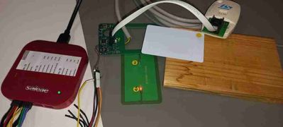

Hi Ulysses,
this ist my setup:
The test is to read cyclic the UID of the chip card. I have made 2 tests:
Please see zip file with both logic analyzer traces. These traces are monitored with saleae logic analyzer. You can download the software at https://www.saleae.com/ for free.
Regards, Andy
2024-10-09 1:32 AM
Hi Andy,
just look at the ST25_IRQ line in the failing case. The IRQ line stays high for a very long time. Lookin at the IRQ just before there is an I_txe which is read in around 60us. 70us after the starts the next IRQ which goes un-handled. So something wrong with your timeouts maybe or your flag not working properly. With the GetInterrupt() it should repeatedly be called and see the pin being high. But apparently that doesn't happen.
Did you also adapt the GetInterrupt() function or only the WaitFor..()?
Ulysses
