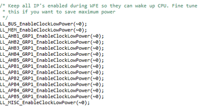

Please also check that the clocks that should not be gated during WFE are indeed not gated (e.g. if the NPU clocks remain ON when you enter WFE, otherwise the NPU will go to sleep as soon as you execute WFE, and no inference can be done ... your system is stuck)
This is done by the lines LL_*_EnableClockLowPower() in the examples provided by @Julian E.
Let us know if this helps.

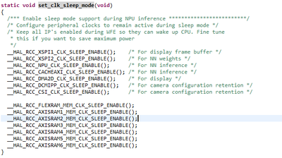

Regarding the clock I have included the lines with  LL_*_EnableClockLowPower() in the end of the hardware init sequence in the same way as is in the examples by @Julian E. but the problem remains. The examples in ST zoo call this function
I noticed that it has the same description as in
So what is the difference?

But usually with RTOS, an independent timer is used as a sys timebase (eg. TIM2). The same problem can then occur when going into LP modes, if TIM2LPEN is not set (part of the RCC_APB1LLPENR), entering in WFE will let the timer stuck.
(using the approach with LL_xxx_enableClockLowPower functions above enables all the clocks during LP modes --less error prone, but will consume more on the whole--, the __HAL_RCC approach is finer-grained, and thus you have to be careful on what you absolutely don't want to clock-gate when in LP)
again, maybe this is not your issue, but better to make sure to check that out :)

August 1, 2025
Hello
Not that i'm aware of... the MCU cache is not used (since the mcu sleeps) and in your case you seem to have let the NPUcache (CACHEAXI) on during wfe.
Did you try to enable all the clocks during wfe ? to check if the issue lies there or if this is totally unrrelated ?
You can also remove AI from your project and just do a "wait for event" with free rtos and check if your code breaks if you fear the culprit is in the "ai" stack. i.e. start simple, verify it works, and then add features to your code, this will ease the debug.
Tell us what you test and what are your results for the test you run...
Best regards.

Can you enable all clocks during wfe and see if this helps ? (sorry, i don't know what you tested/not tested).
As stated above, this can be done with the code you sent full of LL_xxx_enableClockLowPower functions.
