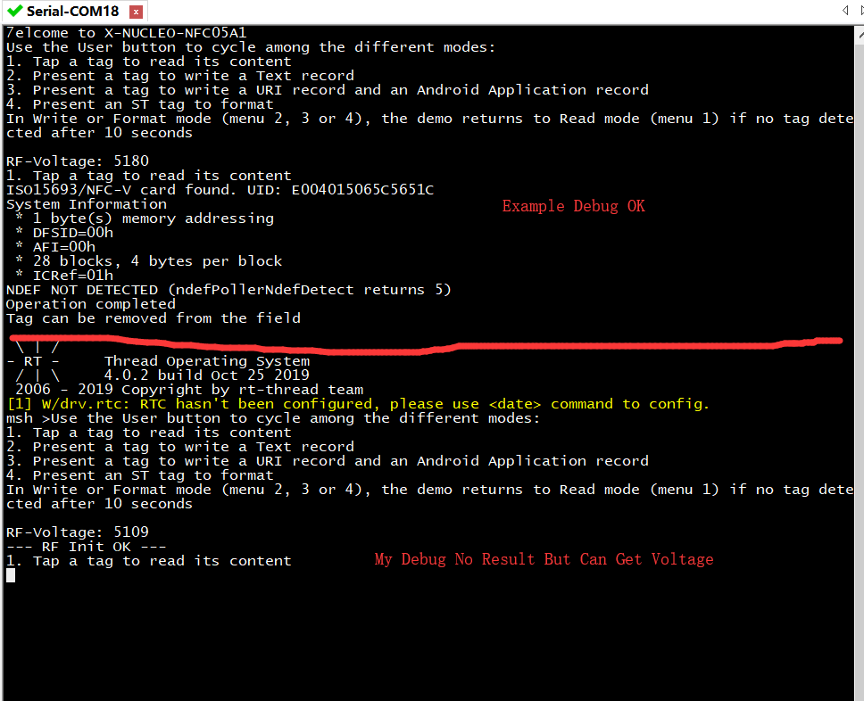

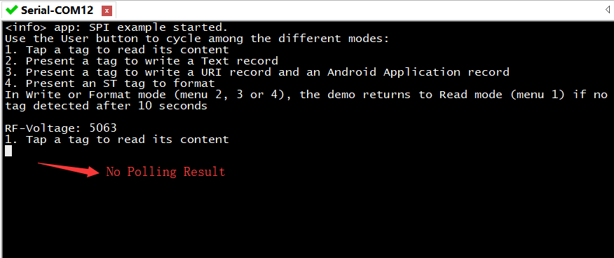

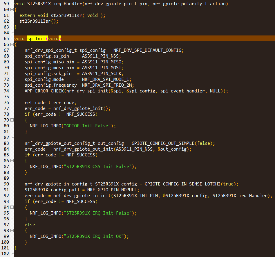

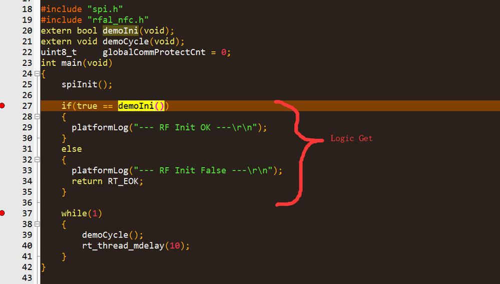

After migrating to Nordic-nrf52832 platform with STM32CubeExpansion_NFC5_V2.0.0, I can initialize successfully (all initialization processes can succeed), and fail to Polling Tag Detect.
Refer to the example completely for program running process
int main(void)
    bsp_board_init(BSP_INIT_LEDS);
    bsp_board_init(BSP_INIT_BUTTONS);
    APP_ERROR_CHECK(NRF_LOG_INIT(NULL));
    NRF_LOG_DEFAULT_BACKENDS_INIT();
    timers_init();
	  spiInit();
    NRF_LOG_INFO("SPI example started.");
	  if( true != demoIni() )
			NRF_LOG_ERROR("************ rfal NG **************");
    while (1)
				demoCycle();
        NRF_LOG_FLUSH();
//        bsp_board_led_invert(BSP_BOARD_LED_0);
        nrf_delay_ms(500);
​Debug Log
Democycle() didn't crash, just couldn't get the card searching result.

rfalInitialize -> st25r3911Initialize -> st25r3911MeasureVoltage

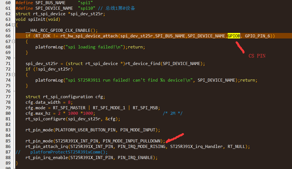

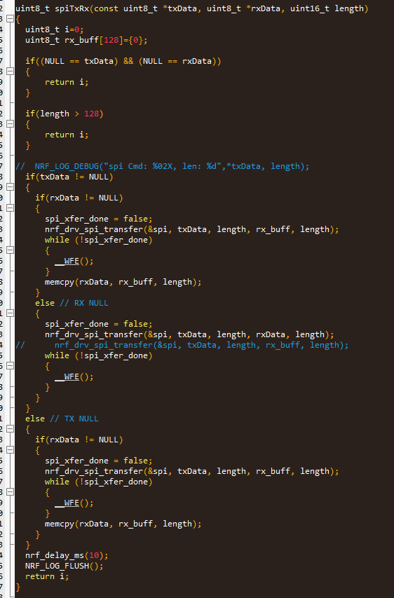

uint8_t spiTxRx(const uint8_t *txData, uint8_t *rxData, uint16_t length)
	uint8_t i=0;
	if((NULL == txData) && (NULL == rxData))
	    return i;
	if(length > 128)
			return i;
	struct rt_spi_message msg1, msg2;
	if(txData != NULL)
		if(rxData != NULL) // RX �?�空
			msg1.send_buf   = txData; // �?��?缓存
			msg1.recv_buf   = rx_buff;// 接收缓存
			msg1.length     = length;
			msg1.cs_take    = 1;
			msg1.cs_release = 0;
			msg1.next       = &msg2;
			msg2.send_buf   = RT_NULL;
			msg2.recv_buf   = RT_NULL;
			msg2.length     = 0;
			msg2.cs_take    = 0;
			msg2.cs_release = 1;
			msg2.next       = RT_NULL;
			rt_spi_transfer_message(spi_dev_st25r, &msg1);
			memcpy(rxData, rx_buff, length);
		else // RX NULL
			msg1.recv_buf   = RT_NULL;
			msg1.length     = length; // �?��?长度
			msg1.cs_take    = 1;
			msg1.next       = &msg2;
			msg2.length     = 0;
			msg2.cs_take    = 0;
	else // TX NULL
			msg1.send_buf   = RT_NULL;
			msg1.length     = 0;
			msg1.cs_take    = 1;
			msg1.next       = &msg2;
			msg2.recv_buf   = rx_buff; // 接收缓存
			msg2.length     = length;
			msg2.cs_take    = 0;
	rt_thread_mdelay(5);
  return i;

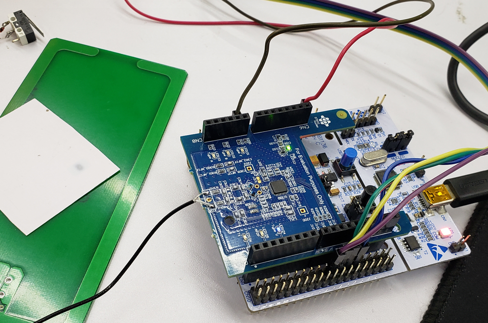

  • Your picture shows an ST Nucleo Board with your antenna. Can it read the tag?
  • On the picture the antenna seems to have some shielding on the bottom top. Better to turn it around
  • Did you adapt the matching for your antenna (inductance)? This is a necessary step for getting the antenna to work. Please refer to AN4974 Antenna matching for ST25R3911B/ST25R391x devices.

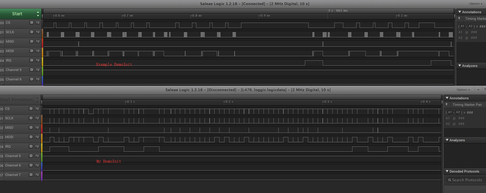

  • The sampling frequency of your Saleae is at 2MHz, this is not enough to sample a 2MHz SPI!
  • Please increase the sample frequency and provide the actual trace file of Saleae, not only screenshots. If you regard this as confidential you can also share through private message.
  • I still see above an rt_thread_mdelay(5) - all NFC action will considerably slow down!
  • The st25r3911MeasureVoltage() just gives the supply voltage. Please execute st25r3911MeasureAmplitude() and st25r3911MeasurePhase() to get the voltage and phase on RFI
  • Please provide result value of st25r3911CalibrateAntenna()
Regards, Ulysses
Under the same hardware platform, I can use STM32CubeExpansion_NFC5_V2.0.0 l476 example without any problem. The antenna matching is OK, and the SPI rate I have tried is useless. Delay time also tried all kinds of useless. Even if you know that the data of logic analyzer is wrong, what else can I do to improve it?
Ulysses HERNIOSUS
typically Saleae can be configured to sample much faster. If your device is really limited to 2MHz, then reduce SPI to 1MHz and send me the traces.
