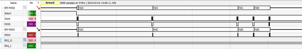

Ok, I have my SPI set for 2MHz and SPI Mode 0, so CPOL=CPHA=0.
Spoiler
Arduino Code: SPISettings(2000000, MSBFIRST, SPI_MODE0)
Just narrowing the scope of my question down to setting the Protocol, I have captured the sequence of sending 0,2,2,1,D to setup ISO15693. MISO is responding C,C,C,D,D
the 0 is the first little box
I don't know why there would be such variability in the time between frames but I also don't know if it matters.
Even though MISO is responding differently than 6, I can put the scope loop by the antenna and measure the 13.56MHz field after sending this sequence.
Brian TIDAL
as explained in my previous post, make sure to have a GTv Guard Time (>5ms) between the ProtocolSelect command that enables the field on and the first SendRcvd command. Then fill free to send me the raw file from the logic analyzer (make sure to include the startup sequence, the protocolSelect and the SendRcvd commands).

PDIhawk
Hi Brian,
I now have Guard Time, is it supposed to be 5s like you said in that last post or the 5ms that you said previously?
I am using an Analog Discovery by Digilent for my logic analyzer.  As far as I know, I can only really grab one sequence at a time like pictured and I don't believe I have any raw file to share.
I am now able to enable the ISO15693 because I get the 0x0000 response after setting it and I can see the 13.56MHz on my scope.
I think my main problem is that I wasn't initializing the ST25R95 properly.  To check communication, I run the Echo command and I was only getting a good Echo response if I cycle the power.  I added the Reset Control during initialization.  Now I get a good Echo response every time I boot and I successfully enable the protocol.
I added the SendRecv sequence that you mentioned above.  After sending the last data byte of that sequence, the processor reboots and loops this reboot.  I tried the example from the datasheet of 0x0403022000 and the same thing happens.
Any ideas?  Maybe this should be the start of a new thread?
Thanks!
Brian TIDAL
sorry for the typo (I've fixed it): this is 5ms.
Regarding the startup sequence, you may find useful information on this community (see for example https://community.st.com/t5/st25-nfc-rfid-tags-and-readers/cr95hf-error-0x71-spi-interface/m-p/329870)
Regarding the reboots, I would suggest to check the power supply and make sure there is no power drop when the ST25R95 starts to emit the field. If support is needed on this topic, I would suggest to create a new thread.
