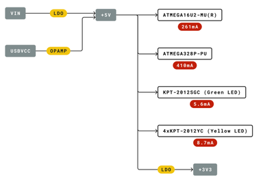

I checked power and found multiple issues. First, I noticed that the X-NUCLEO-NFC03A1 board isn't completely compatible with the Arduino UNO because the 3.3V supply is tied to the IOREF pin. On my UNO SMD, the IOREF pin is 5V and was back feeding 5V into the 3.3V regulator and pulling the whole 3.3V supply to 5V. Thankfully the ST25R95 5V tolerant, so nothing is broken.
After bending back the IOREF pin so the NFC03A1 board doesn't see it, I found out that the 3.3V supply is only capable of 150mA. Since the ST25R95 can pull up to 100mA during RX/TX, I was hitting the current limit and the 3.3V was significantly drooping.
I landed on bending the 3.3V pin on the NFC03A1 board to power it with the UNO 5V supply. There is still a 0.1V droop but it is much better than the 3.3V supply. I think this should still allow it to run but it is still stuck in a reboot loop when trying to do the SendRecv sequence.

the X-NUCLEO-NFC03A1 is designed for 3V3. The IOREF (CN6.2) and the 3V3 (CN6.4) are internally connected. When a 5V IOREF is used on the MCU board, the IOREF pin should be bent to prevent injecting 5V to 3V3.
The Arduino Uno Rev3 SMD can be supplied through the USB or through the VIN. I guess the USB is being used in your case.
Can you try to supply through the VIN with a lab supply? See the Power chapter on the https://store.arduino.cc/products/arduino-uno-rev3-smd web page regarding the recommended 7V-12V range for VIN.

I was powering off USB only but added an external power supply plugged. It was only a 5.9V supply in and it wasn't helping probably because it was too low for the LDO on the UNO.
However, as I was playing around with some of the code, it just started working. I don't know why any of the code changes would have fixed this reboot cycle, but, no matter what I do, I can't get it to go back into the reboot cycle.
I even unbent the 3V3 pin to the X-NUCLEO-NFC03A1 and it is running on the 3V3 of the UNO.
I don't feel completely comfortable with this because I don't know what fixed it but it appears to be working. However, this is just evaluation hardware and I think that this was probably a hardware problem.
