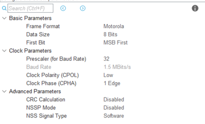

do you use the X-CUBE-NFC3 firmware package or the ST25 embedded NFC library from st.com or your own implementation? Which communication interface is being used: SPI or UART? What is your SPI configuration (in particular the SPI baud rate)? See typical SPI configuration below:
Can you connect a logic analyzer (Salae, Digiview, picoscope, etc.) on SPI (CLK/MOSI/MISO/CS) + IRQ_IN + IRQ_OUT and send me the raw file?

Thanks for your answer. I'm still stuck. I am using spi communication. I try to connect a logic analyzer unsuccessfully.
First I was using my own implementation, but I also try to use the ST example code adapted for NUCLEO-F722ZE board but it did not work. It fails inside the function st25r95Initialize.
I want to know if NUCLEO-F722ZE board is compatible with x-nucleo-nfc03a1, or if I should use another board.
Any suggestion on how to go on is welcome, as I must move forward with my university project.

I do not see reason why the NUCLEO-F722ZE could have incompatibility with the ST25R95.
Can you start a debugger and share more information about the failure in st25r95Initialize. Have you properly configured the IRQ_IN, IRQ_OUT and SSI0 GPIOs? What is the SPI clock configuration? Make sure the SPI is < 2Mbps.
This will be difficult to provide support without have visibility through logic analyzer traces. Make sure to have someone helping you to get traces.
