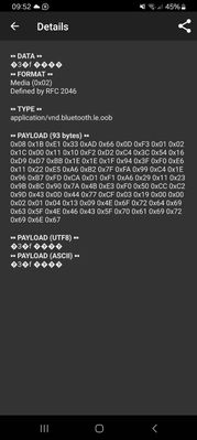

I have successfully ported the ST25R95 library from STMicroelectronics to my own microcontroller, an nRF52832. I am now trying to read the payload of an NFC-A Passive ISO-DEP device with the UID: 5F471DC2783A8E.
In the polling_demo.c file, I see the function demoAPDU. I would like to use this function to read the payload, which contains Bluetooth Out of Band (OOB) data and a key. My goal is to use this for BLE NFC pairing. Can someone assist me with this?
Here is the payload:

I am now able to read the NDEF message, but I don’t get a Bluetooth address. Does anyone know how to fix this? Here is the output I’m getting:
NFC-A Passive ISO-DEP device found. UID: 5F471DC2783A8E
READ/WRITE NDEF detected.
Decoding NDEF message:
Record #1
Flat payload (length 13):
[0000] 15 C1 02 00 00 00 04 61 | . . . . . . . a |
[0008] 63 01 01 30 00 | c . . 0 . |
Record #2
Bluetooth:
  • Type: 0x11
  • Device Address: (length 0)
  • EIR Flags: (EIR length: 0x03, EIR type: 0x01) (length 1)
    [0000] 04 | . |
  • EIR ClassUUID16_partial: None
  • EIR ClassUUID16: None
  • EIR ClassUUID32_partial: None
  • EIR ClassUUID32: None
  • EIR ClassUUID128_partial: None
  • EIR ClassUUID128: None
  • EIR Short Local Name: None
  • EIR Local Name: (EIR length: 0x14, EIR type: 0x09) (length 18)
    [0000] 4E 6F 72 64 69 63 5F 4E | N o r d i c _ N |
    [0008] 46 43 5F 70 61 69 72 69 | F C _ p a i r i |
    [0010] 6E 67 | n g |
  • EIR TxPowerLevel: None
  • EIR Device Class: None
  • EIR SimplePairingHash: None
  • EIR SimplePairingRandomizer: None
  • EIR SecurityManagerTK: (EIR length: 0x12, EIR type: 0x10) (length 16)
    [0000] 3A 32 40 F7 9B CF 65 84 | : 2 @ . . . e . |
    [0008] E8 AB C3 5B B4 15 DD D7 | . . . [ . . . . |
  • EIR Security Manager Flags: None
  • EIR SlaveConnIntervalRange: None
  • EIR Service Solicitation: None
Any guidance would be appreciated. Thanks!

on my side with your record, I have the following decoding where the LE Device address is displayed:

I believe your decoding or ndef_dump functions are old. Which package and which version have you used? With a debugger, set a breakpoint in ndefBluetoothDump() and check the value of type->data.bluetooth.eir[0]. It should contain the first EIR (in your case, the LE Device Address element)
