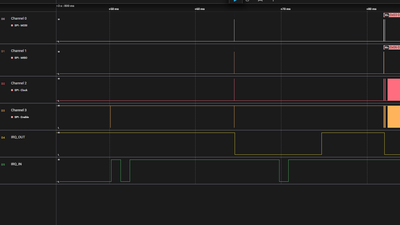

Hi BT,
The project compiles now, and I’m running the NDEF example as described above. However, I'm encountering an issue with the initialization of the ST25R95. The logic analyzer data appears to be fine to me, including the setup with the timing on the IRQ_IN pins and the data sent to the chip. Unfortunately, I’m not receiving any data back from the ST25R95.
I've attached some pictures from my logic analyzer for your reference. Could you please help me figure out what might be going wrong?
This is where the IRQ_IN sequence starts:

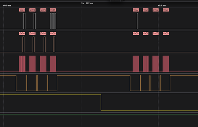

Here comes the reset command:

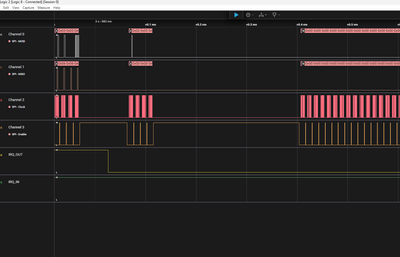

Here comes the Echo command:
And the read command but no data coming back:
good to see that your project is now linking. I had a look to the screenshot. The SPI CS-chip select (or SS or CE) is wrongly managed.  The CS has to stay low during the whole transmission of a given command frame:
