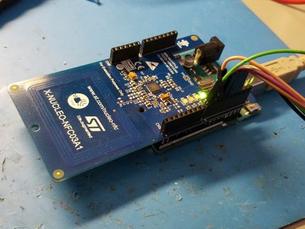

Using my Arduino UNO and X-NUCLEO-NFC03A1 with the ST25R95 I am having issues trying to stay in IDLE.
For DacDataL and DacDataH, I have tried both the recommended 0x64 and 0x74 for the demo board and the 0x90 and 0xA0 that came from Tag Detection Calibration.
Approximately every 552ms it jumps out of Idle state and the IRQ_O never goes LOW.
I have attached a trace.  I still haven't been able to capture a trace that includes IRQ_O.
It shows boot, going into Idle, jumps out of Idle, polls for reading, reads and goes back to Idle.
Why might my code be jumping out of Idle mode?

I've seen a protocolSelect ISO14443A in your trace before going to Idle. Make sure the field is OFF before going to Idle mode (ie. send a 00 02 01 00 = protocolSelect FieldOff ).
The IRQ_OUT returns high when the response from the device has been read. Therefore, before sending a new command, the response of the previous one has to be read.

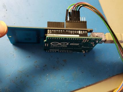

Can you share a picture of your HW setup? Is the X-NUCLEO-NFC03A1 antenna covering some electronics part of the Arduino board?

Ok, after closer looking at the ST32duino library code, I was missing an nIRQ Pulse on boot.  I had the one after reset but not on boot as I should have.
After turning the Field OFF before Idle and adding the nIRQ Pulse before the Reset command, my problems above are fixed.
