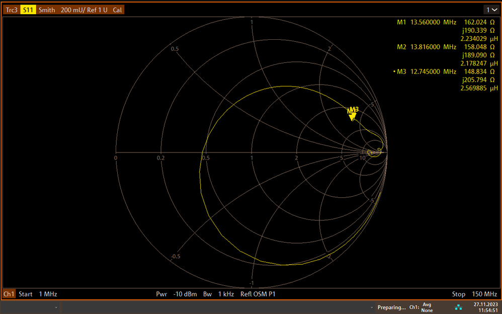

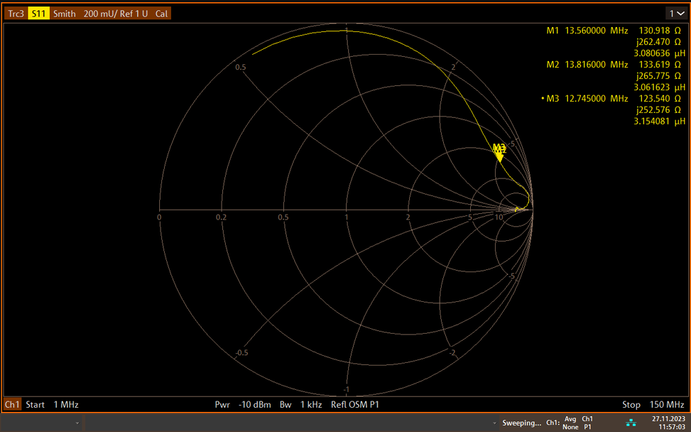

I'm a colleague of Kai, we work together on this NFC project.
We did several comparison measurements. In particular, we measured the antenna of the ST25R3911B-DISCO with and without matching network. Not only with our VNA, but also with a higher class instrument in an EMC-facility.
For some reason our results differ from the Smith-diagrams found in AN4974.
I compared the results (with and without matching network) of an unpowered, unmodified ST25R3911B-DISCO board with the results of the same board, where only the matching network and the antenna were visible for the VNA. (All other connections towards the NFC chip were "open". Also the 2x main output wires at the bottom side were cut, which have no 0R resistors in the signal path.)
After these comparison measurements we saw that the unpowered chip pins are "high-Z" and have almost no impact on the results of the antenna measurements. It is clear, that in this case the effect of the AAT capacitors was also not there (and so these are not trimmed the resonant frequency to the desired value).
The AN4974 recommends to use a powered board for the VNA measurements (page 41, chp. 7.4). However the board should be reconfigured to deactivate the RF output stage and disable any voltage output (which could cause damage to the VNA input).
So we itentionally measured always only an unpowered board to avoid any possibility of any damage to the VNA (e. g. in case of a not performed reconfiguration).
At the measurements with matching network, the VNA was connected according to AN4974 fig. 34
At the measurements without matching network, the VNA was connected to J402 and R401 and R402 were removed.
The pictures of our measurements:
Antenna with matching network (we expected a plot like figure 35 on page 42):
Antenna (of the evaluation board) without matching network:
My question is, why we see an entirely different plot at the first picture compared to figure 35 of AN4974.
If You could please do a measurement at J402 without R401 and R402, You should get the same plot as at the second picture.
This would be my starting point to clarify, where the difference coming from.
