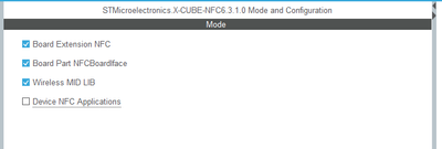

Also, in CubeMX / CubeIDE I can see the following configuration options (see screenshot).
However, I'm unsure what to select in terms of the “Board Extension” and “Board Part” settings. Since I’m not using any ST eval board, just the bare ST25R3916B, I don’t know which options are still relevant, and which might introduce unwanted dependencies.

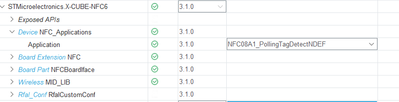

@Brian TIDAL That would be great. Currently i've set the NFC Middleware Settings as Board Parts / Extension.
Brian TIDAL
The Device NFC Application has not been selected in your setup:
Make sure to select it if you want the demo being included. In your case this is the ndef_demo as the NDEF application has been selected:
I've seen that the FreeRTOS is being used. I would suggest you have a look to the FreeRTOS demo inside the ST25 embedded NFC library.
