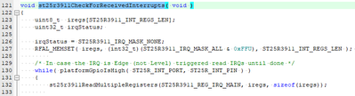

I'm using RFAL v2.6.0 and ST25R3911B and I get an issue with the IRQ management.
Using ISO14443 Type-A tag,  the IRQ remains high causing the while loop not to exit.
In this condition, the i_err bit of the main interrupt register is '1' while the two  interrupt registers (Timer and NFC interrupt register and Error and wake-up interrupt register) have all of their bits to '0'.
Reading these register in a loop cannot clear the i_err bit.
The last content prior the lock state is:
- Main interrupt register: 0x33 -> i_rxs, i_rxe, i_tim, i_err
- Timer and NFC interrupt register: 0x20
 - Error and wake-up interrupt register: 00  (Should be different from 0)

" the IRQ remains high causing the while loop not to exit". Do you refer to the while loop inside st25r3911CheckForReceivedInterrupts:
Can you connect a logic analyzer on the SPI (CLK/MISO/MOSI/CS) + ST25R3911B_IRQ and provide the trace  from the analyzer?

Hi Brian,
This is a custom board using an ESP32-WROOM-32E as MCU (OS is ESP-IDF based)
SPI communication is 5MHz.
Yes I refer to the while loop inside st25r3911CheckForReceivedInterrupts.
In our implementation, the function is called from a high priority task which is notified by the GPIO ISR as it is not possible to execute the full st25r3911CheckForReceivedInterrupts in an IRQ routine (too long for a multi-task, multi-core OS).
Please also note, that I have absolutely no problem using ISO15693 tag.  The problem occurs only with ISO 14443-A configuration. It looks like the i_err is raising without having other bits set and so in this condition it is not possible to clear it just by reading the registers as they are already cleared.
And the RFAL is working well if I remove the while condition.

I log the contents of the three interrupt registers in the function and the status is clear:
Every thing is working as expected until we get i_err=1 in main register with a null register 19 h (that should be impossible). After this I read in an infinite loop the three registers to:  0x01 0x00 0x00
If it was something about SPI communication, reading again and again should clear all the bits at one time.  Am I wrong ?

Hi Brian,
I have test the solution propose by Ulysses and it works.
No I have the following code:
    while( platformGpioIsHigh( ST25R_INT_PORT, ST25R_INT_PIN ) )
        st25r3911ReadMultipleRegisters(ST25R3911_REG_IRQ_MAIN, iregs, sizeof(iregs));
        irqStatus |= (uint32_t)iregs[0];
        irqStatus |= (uint32_t)iregs[1]<<8;
        irqStatus |= (uint32_t)iregs[2]<<16;
        if( iregs[0] & 0x01 )
               st25r3911ExecuteCommand(ST25R3911_CMD_CLEAR_FIFO);
This is the only way to clear i_err bit in main interrupt register (whatever other registers values are).
we are still puzzled why this would be happening. We have seen weird issues also when the SPI driver was not doing what it was supposed to be. So I would really like to see a logic analyzer trace of the communication in this case.
Also for your workaround implementation: I would likely make it more specific by moving to
 if( (iregs[0] & 0x01) && (0 == iregs[2]) )
 BR, Ulysses
