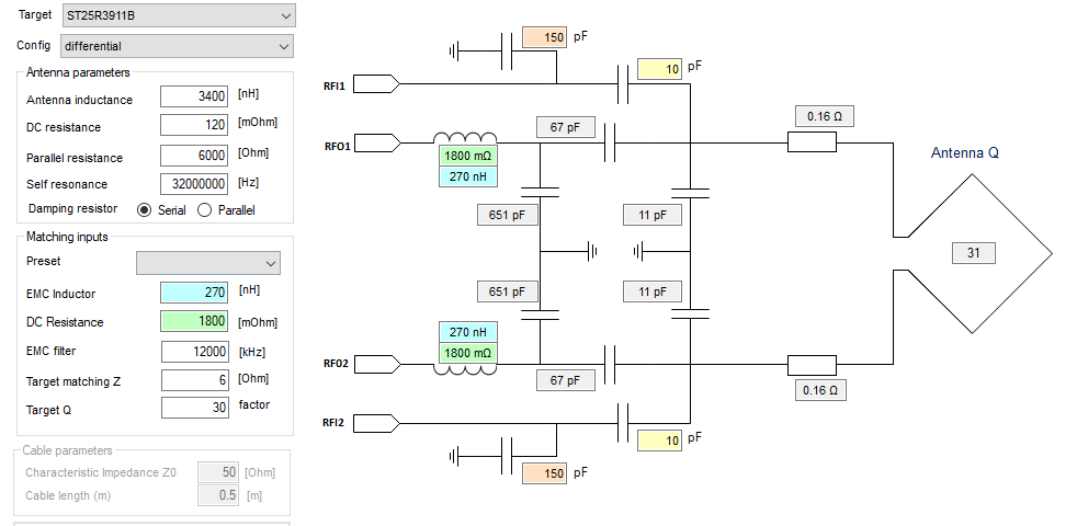

  • And second question about my matching. I match my reader antenna like this : 0693W00000SuMk0QAF.png
but the results are not really good. Is there a problem somewhere? I use a 2 turn 20x30cm antenna, is my inductor value too high?

Hello Vincent,
I assume you are using the inventory command to collect all UIIDs in the field. The disco GUI is driving the ST25R3911B. So there is the USB interface in between. this is causing additional delays. It might be possible to further optimize if the code is directly running on the MCU. If you could share a bit more details about the used commands we could do further proposals.
The inductance value should be still in a good range. Can you maybe share the smith chart coming from the VNA?
Thanks, BR Travis
