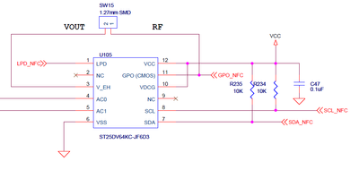

Hi Rene
As it turns out I was working with the wrong schematics of our board.
The package is actually the 12pins one and there are pull-up resistors as shown in the pic below.

Hi Alex_B,
Can you confirm that LPD pin (1, input) is forced low? Otherwise ST25DV will be set in Low power mode.
GPO (11) is an output and can be connected to an input on your MCU (used as interrupt), can you confirm it is the case?
For pull-up resistors if you set your I²C to Standard mode (100 kb/s), it should work.
For higher speed, change your Pull-up resistors as indicated in the previous messages, but be sure to respect the MCU I2C timing configuration (as tHD;DAT, tSU;DAT, ...).
Kind Regards.
Hi Rene
Yes the LPD pin is forced low and the GPO is connected to an input (interrupt) and after configuring the GPO via the android app over RF I get interrupts from the ST25DV, and yet I can't get to established i2c connection.
