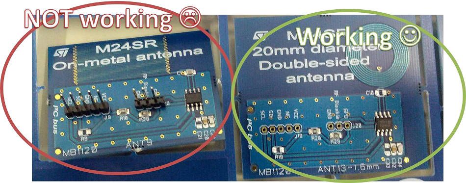

Hi everybody!
It's my first post here and it's my first time working with STMicroElectronics stuff so please be aware I will probably ask very simple or even stupid questions. Please have some patience with me! :)
By the way, I just received my M24SR antenna suite. It is nice :) In their initial state, I can write and read all M24SR tags in there by using the NXP TagWriter Android Application. No problem, several times, everything is ok.
However, when I solder some headers to the boards. I can only write it down once, and then when trying to read it says ''this item is used, blocked, or not supported and cannot contain an NFC data set''. I feel strange about this, since I have not even messed with passwords and so on. The soldering is nice and this happened with two different boards.
So, what I'm not taking into account? My plans are to interface a M24SR to an external MCU (microcontroller) so for first steps I need to wire some of this headers.
Ok, let me know your opinions! I attach some photos of my case
I will be waiting for your answers! See you soon.

Posted on March 21, 2014 at 11:24
in order to help you, I have a bundle of question, sorry about that.
- what is the nfc phone you are using?
- might you please test with our application
https://play.google.com/store/apps/details?id=com.nfc.m24srdemo&hl=fr
- might you please confirm there is not any short on the soldering header?
and also what is the read range you are trying to achieve?
Have a nice day,
Best regards,
ST NFC/RFID Dynamic tag e2e support

Posted on March 21, 2014 at 15:44
no problem in answering questions!
In fact, it is weird, writing with M24SR application works and from now on, everything works again, even with other NFC apps. No shortcircuit present, I checked.
- I'm using a Galaxy Nexus. However, perhaps yesterday the battery level was lower. I don't think this may affect but...
- No problem about the read range, in fact I'm doing my first steps. The big antennas allow for larger ranges but I guess any design I prepare with an inductance around 5uH will do the trick ;)
- I plan to interface this with a MSP430 from TI, so let me know if there are current ongoing efforts in this direction. By the way, in order to implement as few code as possible, since I have code size constraints, I would like to know the minimum list of commands I have to send in order to read the content of the tag.
- Final question, how can I mark this question as solved?
Have a nice day!
