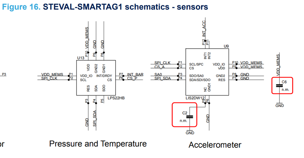

Hi, I was just wondering if someone knew what n.m. meant on the schematic of the SMARTAG1. I assume do not populate but if so what purpose do these components serve if populated?
Thanks.

You mean these:
https://www.st.com/resource/en/user_manual/um2427-how-to-use-the-st-nfc-sensor-tag-evaluation-board-stmicroelectronics.pdf#page=25

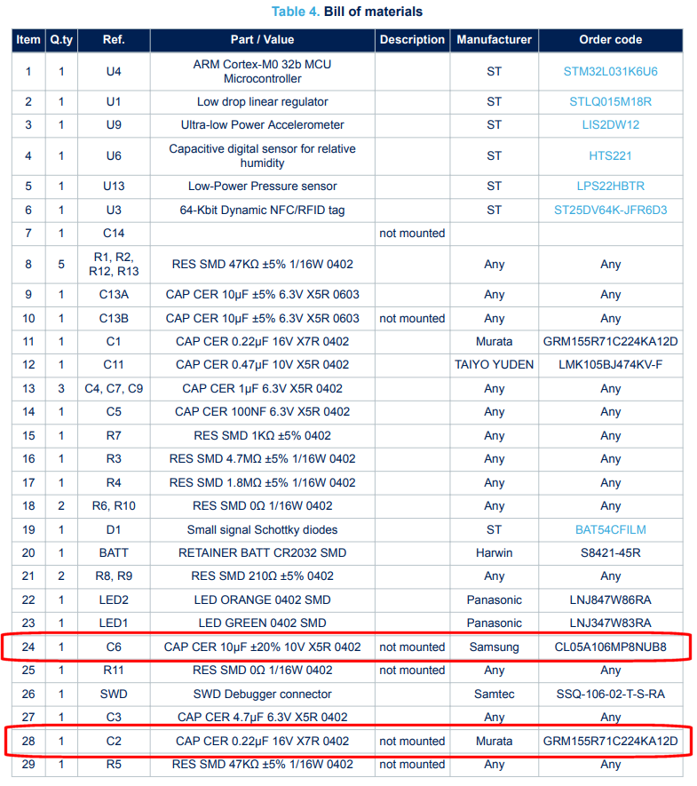

Indeed, it is stated in the Bill of Materials that these are not mounted:
Presumably to accommodate different variants/revisions of the board;  eg, using a different accelerometer?
