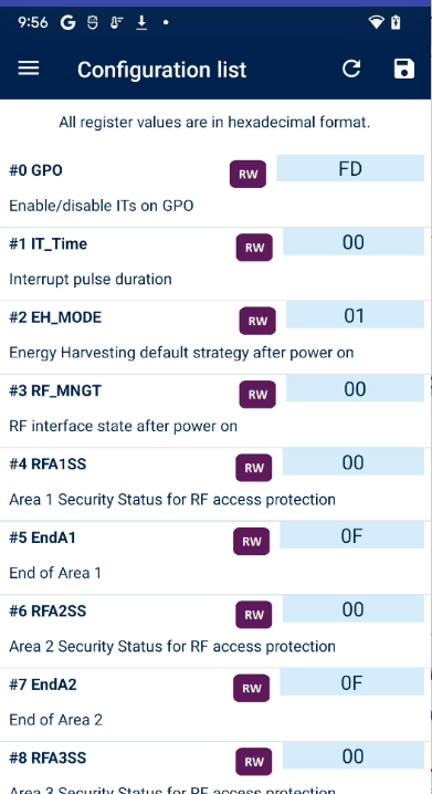

After testing with ST25 Android app, we noticed that the same CustomCommand (00 A9 02 01) executes well on one Samsung phone (S20, Android 12, with S3NRN4V NFC chip) but returns TAG NOT IN THE FIELD on another Samsung phone (S21, Android 12, with SN110UV3 NFC chip).

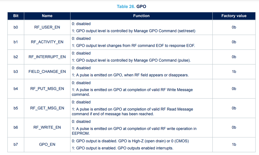

On receiving the Manage GPO command. Depending on the command argument, the ST25DV force the GPO output level if RF_USER interrupt is enabled, or send a pulse on GPO output if RF_INTERRUPT is enabled. If neither RF_USER nor RF_INTERRUPT was enabled, the command is not executed and ST25DVxxx responds an Error code “0F�? ...

_legacyfs_online_stmicro_images_0693W00000bjlNoQAI.pngPlease check that :
bits b0 RF_USER_EN=1 and b7 GPO_EN=1
_legacyfs_online_stmicro_images_0693W00000bjlONQAY.pngConcerning behaviors on mobiles, no ideas at this stage
Best regards, FB
