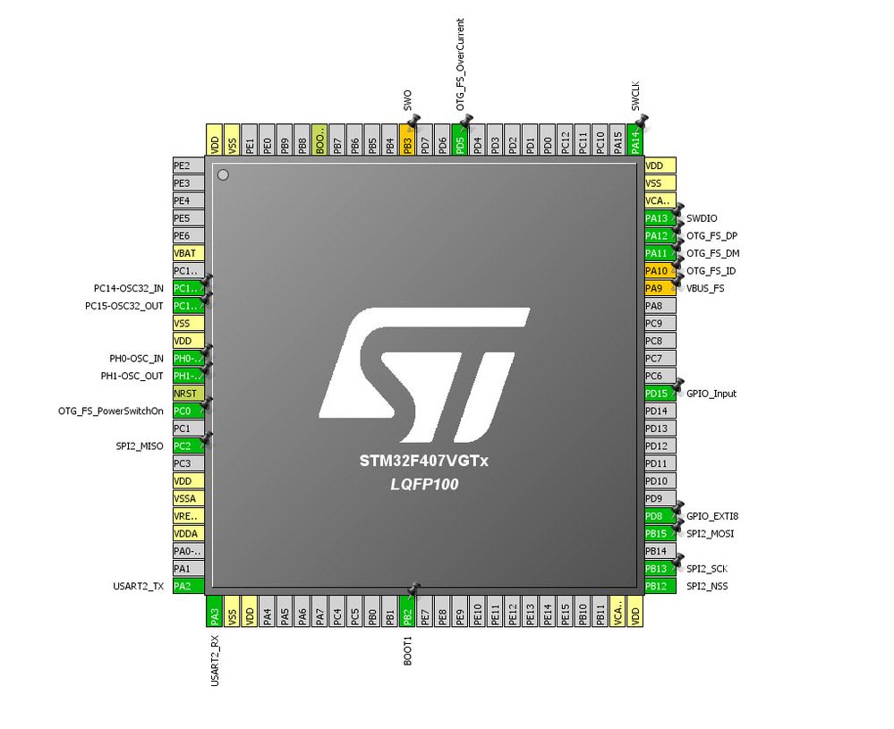

Hello everyone ,
I have my own PCB which its antenna connection is so similar to ST25R3911B-Disco - MB1325C-01 board , but my cpu is st32f407 , and base on ST25R3911B_DISCO_FW_v1_2_00 and also stm8_nfc05 I want to read UID at the first step .
rfalInitialize() == ERR_NONE is ok
and
void EXTI9_5_IRQHandler(void)
 /* USER CODE BEGIN EXTI9_5_IRQn 0 */
 HAL_GPIO_EXTI_IRQHandler(GPIO_PIN_8);
 while( HAL_GPIO_ReadPin (GPIOD,GPIO_PIN_8))
 st25r3911Isr();
is working fine .
but I do not know what sequence and which commands should be send to do it .
I have try in wakup mode by :
 st25r3911Initialize();
find=iso14443AInitialize();
        find=iso14443ASelect(ISO14443A_CMD_REQA , &card, 0);
dispute that find=0 when Mifare card is there , but card.uid in incoorect and card.actlength =0 !!
could you please help me in that issue ?

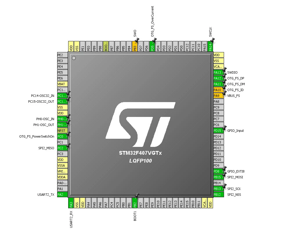

    0690X000006CUTGQA4.jpgDear Gregoire
    Thank you for you reply,
    As I told I have made my own HW ( st25r3911b and its antenna connected to stm32f407 , I will send its cube file .
    The major of my SW project is ST25R3911B_DISCO_FW_v1_2 which I port it to stm32f407.
    As I could not make a proper USB connection to ST25R3911B Discovery GUI .exe or ST25PC-NFC.exe ( I can not really find why and it was a big problem in other distinction which has no result ) I decided to use only demo.c and demo.h files from stm8_nfc05 to make it in my own project .
     I tried to find NUCLEO demo but I could not , could you please tell me in which file i can find it ?
    I was hard to attach all project , so I just send some principle files .
    I will send my project also for you to check it , and I will appropriate you a lot if you can help me .
