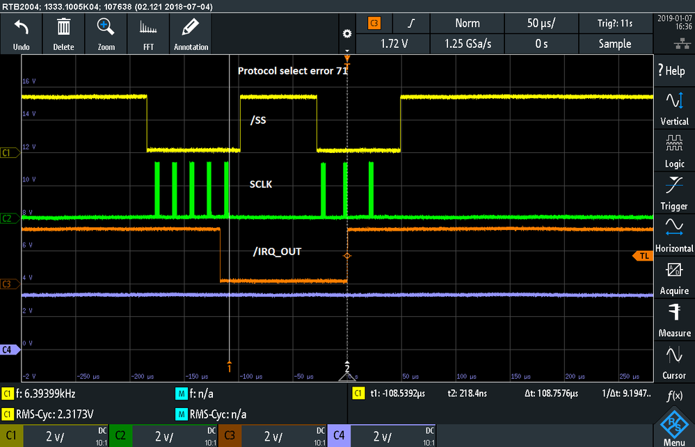

I have a CR95HF transceiver connected over SPI interface running at 2MHz. When I send the protocol select command I get the error 0x71 (EinternalError) .
The IRQ_OUT goes after the 4-th byte low .
Clock, MISO, MOSI looks ok.
Send data 00 02 02 01 0d
Get data 0E 71 00
What means this error?

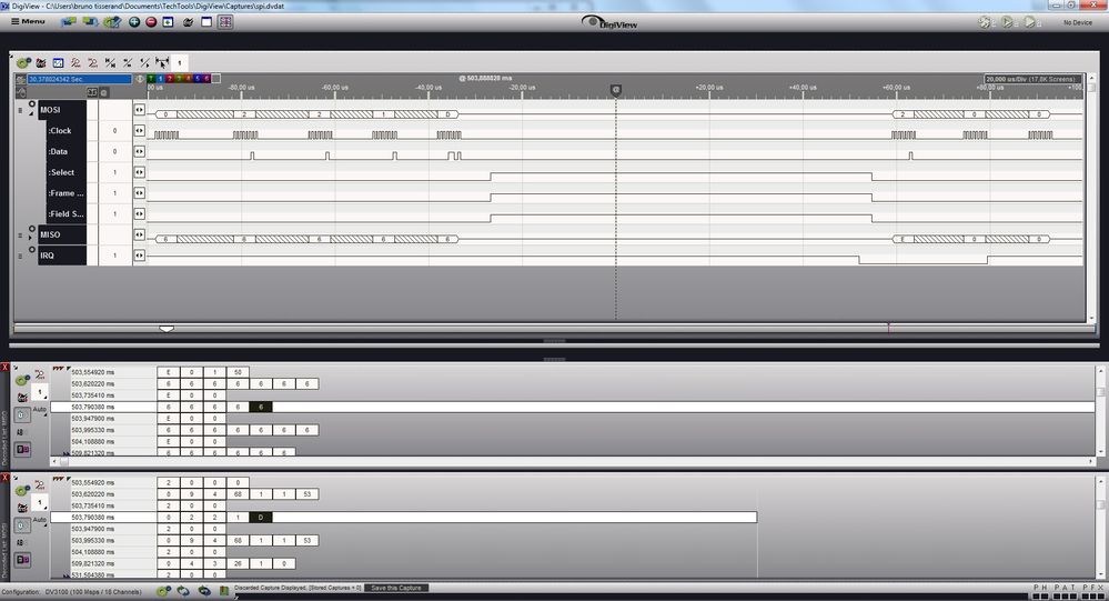

Brian TIDAL
Hi Gaby
In your first screen capture, the IRQ_OUT goes low before the end of the frame whereas it should goes low after the reception of the full frame. So it seems there is a transmission error on the first bytes and the CR95HF reacts immediately and send an error response.
Would you please make sure that your SPI clock frequency is not exceeding CR95HF max value (2.0 MHz).? On my side, I use a lower SPI clock frequency (~1.5 MHz) with an X-NUCLEO-NFC03A1 expansion board and I do not face communication issue. Would you please try a lower frequency than the 2.0MHz limit (e.g. 1.5 MHz) ?

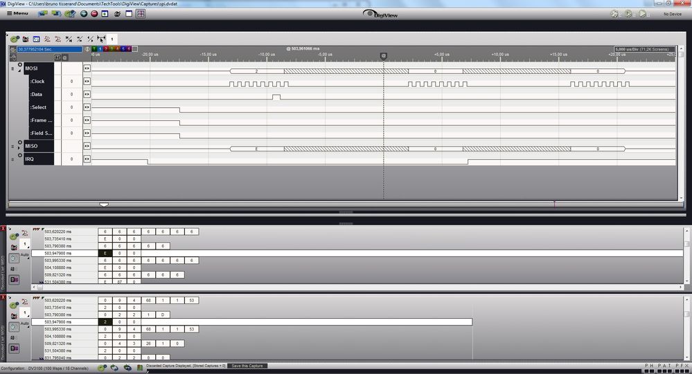

>>> (0x00) 0x0202010D (Protocol Select)
<<< (0x0E) 0x0000 (Result Code reply)

gaby_bradu2
Hi Brian,
thanks for the answer.
   MCU - STM8AF52
   board - own design, (serial interface - MCU - SPI /CR95HF)
   no standard ST driver used
The hardware is ok, it works since about 2 years. The only function from MCU was just after restart to manage the /IRQ-IN singnal after this just get serial data & send over SPI. The PC was responsible for CR95HF configuration & data transfer (protocol select, WR registers, rd/wr data, etc...)
Now it's intend to do the initialization directly by MCU, this means:
   low impulse on /IRQ_IN
   send protocol select cmd.
   send write registers cmd.
Back to the problem:
   MCU manages /IRQ_IN - PC does the initialization & data transfer : everything ok
   MCU manages /IRQ_IN & initialization (protocol select, wr register) : bad answer from CR95HF
Startup sequence:
t0 : 4ms
t1 : >50us
t3: 12ms (tested up to 2s - no change)
SPI setting CPHA=0, CPOL=0 (CPHA=1, CPOL=1 tis also ok)
fSCK - 2MHz (tested with 1MHz - the same)
The timing regarding Table 33 is checked - looks ok. tSU(NSS) ~7us (set/reset from the main loop)
I suppose it is something critical with the timing on start-up or between the bytes, commands...
I get very often as an answer for the first telegram after /IRQ_IN pulse an IDN response.
With the oscilloscope I can see nothing :(

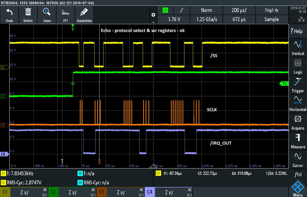

I changed the start sequence:
   /IRQ_IN pulse
   delay
   echo command
   get echo answer
   select protocol command
   get answer
   write registers command
   get answer
In this way it works.
Attached some fotos, maybe it will be help somebody else :)
