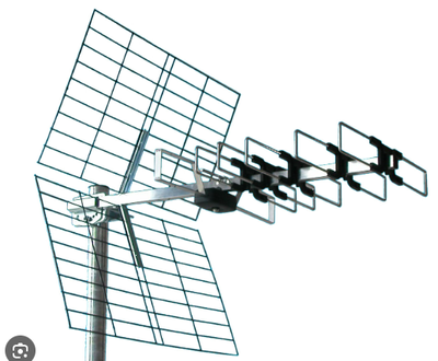

Also size and shape of the conductive area rel. to the antenna form and size is important,
to modify the 3-D form the field gets as result , not just being an absorber for the field.
Just think on the RF antennas, small difference in size makes a reflector or a director for a certain frequency:
...and the optimum distance to get the desired effect.
