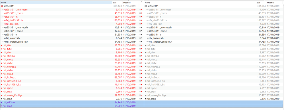

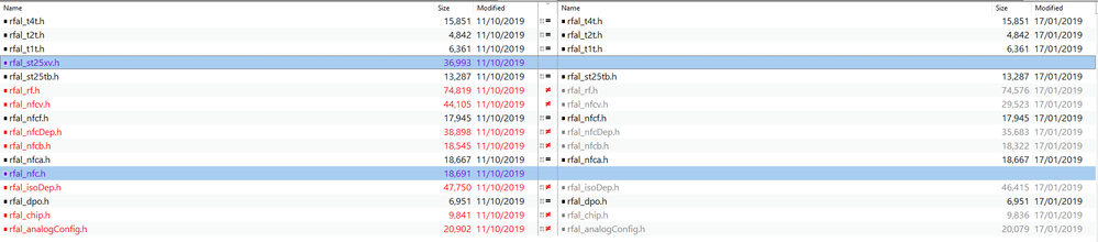

Thanks for the answer.
But unfortunately, ST25R3911B-DISCO firmware (STSW-ST25R002) , seems, does not have integrated this latest version of en.STSW-ST25RFAL001 in to.
Files - rfal_st25xv & rfal_nfc are new in this latest RFAL. And, this particular version of DISCO fw (including platform.h) does not define RFAL_FEATURE_NFC_RF_BUF_LEN, RFAL_FEATURE_NFC_DEP_PDU_MAX_LEN, RFAL_FEATURE_NFC_DEP_BLOCK_MAX_LEN ... 0690X00000As1QrQAJ.png0690X00000As1QmQAJ.png
can you please detail what exactly you want to achieve and which problems you encounter? Why do you want to change rfal version of ST25R3911B-DISCO?
Inside the ST25R3911B-DISCO the rfal_nfc.c/h is not used so changing RFAL_FEATURE_NFC_RF_BUF_LEN will not have any effect.

I am trying to use ST25R3911B-DISCO to get NDEF data reading from M24LR16E over ISO-15693. But, in my custom board, I will use STM32F091, instead of STM32L4, interfaced with ST25R3911B.
Now, when I was trying to integrate ST25R3911B-DISCO fw with STM32F091, apart from RFAL, found that I would need dispatcher, stream_dispatcher, platform, iso15693_3.
Brian said, I should be looking into rfal_st25xv. Then I found the need for latest version of RFAL - en.STSW-ST25RFAL001 & rfal_nfc.
So, now, can I avoid rfal_nfc ?

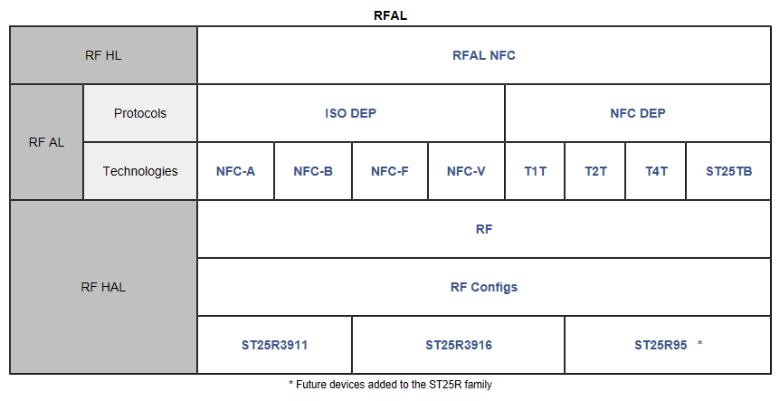

Got a better idea of it from the below picture of RFAL documentation.
For my case, RFAL NFC - ISO DEP - NFCV - to ST25R3911.
