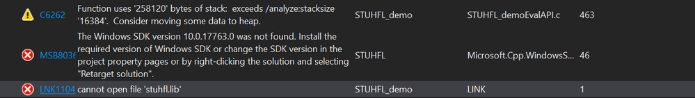

I want to read a tag with my own Reader Circuit Board- st25ru3993. I use Nucleo L476RG as the master. which functions do I need to include in order to read a tag? I've tried and open the demo solution but it didn't work. Can someone kindly help me out?

Looking at your traces, it seems your build environment is not correct.
Indeed, you have the message "The windows SDK version 10.0.17763.0 was not found. Install the required ....", meaning VS cannot proceed to the compilation/linking completion,
this explains why stuhfl.lib is not generated.
Could you please try to complete your build environment,
the demo will be running.

0693W000008y4diQAA.pngwhen I tried to open the solution STUHFL_demo and build it. I encountered this problem. And I couldn't find the file stuhfl.lib anywhere.

The Demos building from scratch is part of our delivery process, I can confirm the demo project builds.

Bao Le Gia
thank you, I will try to rebuild it.
