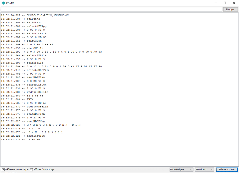

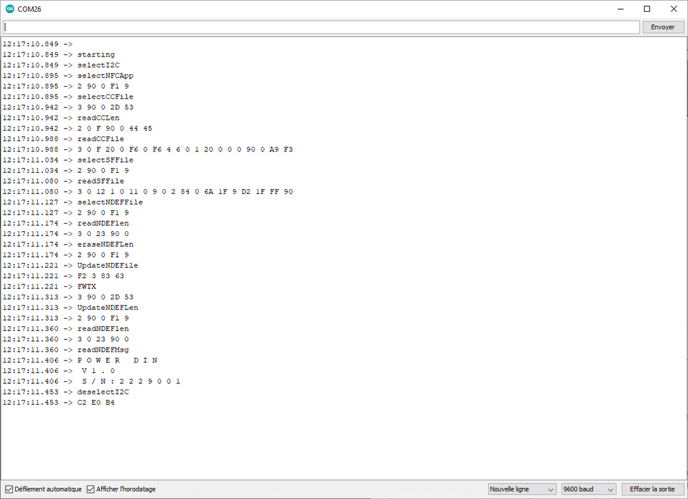

Then I tried to write "Hello world" in the NDEF memory of M24SR and it was written into the memory, and I succeded to read it (only one time) with my cell phone.
So now, I have written another message, I think it's well writed into the memory (please see picture below) but I cannot read it with my cellphone.
I have one question :
  • After that I closed the I2C session, does I need to do something to reactivate the RF ? Because, by reading the System file, I see that the byte (offset = 0x0006) is sometimes at 0x09 (RF enabled) and sometimes at 0x00.
I hope my resquest is enough clear, please find below the different questions/answers between µc and M24SR.0693W00000QLcU5QAL.png

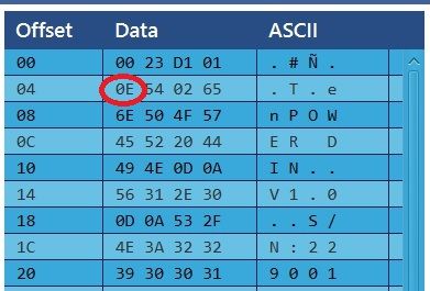

Hi Fabrice,
the NDEF is malformed. The text record has an incorrect payload length (0E):
0693W00000QLdLJQA1.jpgThe correct payload length for the Text record should be 1F:
Rgds
BT

Brian TIDAL
can you install the ST25 NFC Tap App on you smartphone and use this application to read/dump the raw content of the NDEF file after your last NDEF Write ?
Rgds
BT
fab04

Thank you for your quick answer.
I've tried with ST25 NFC tap App.
When the dev board is disconnected (without any supplies), the app can read the tag, but there is nothing in the NDEF tab (I cannot see my recorded text), but I've put in the memory the right bytes (0xD1,0x01...)0693W00000QLcqaQAD.pngWhen the dev board is connected to my ESP (VCC supply by it), nothing happens, the dev board is not detected.
If needed, please find above my code.

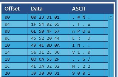

can you go to the MEMORY tab of the ST25 NFC Tap App and read the raw content of the NDEF file?
Rgds
BT
fab04
So I went to the memory tab and then read memory. It seems to detect the tag but the app displays "command failed".
Brian TIDAL
Hi Fabrice,
Rgds
BT
fab04
Thank you for your answer, it works. Effectively this byte correspond to the size of payload, and I forget to change it (I kept the size of my previous test).
Now, it works without any supplies (only the cellphone supplies the tag). So I need to check when the tag is supplied by VCC.
I'll let you inform.
Thank again.
